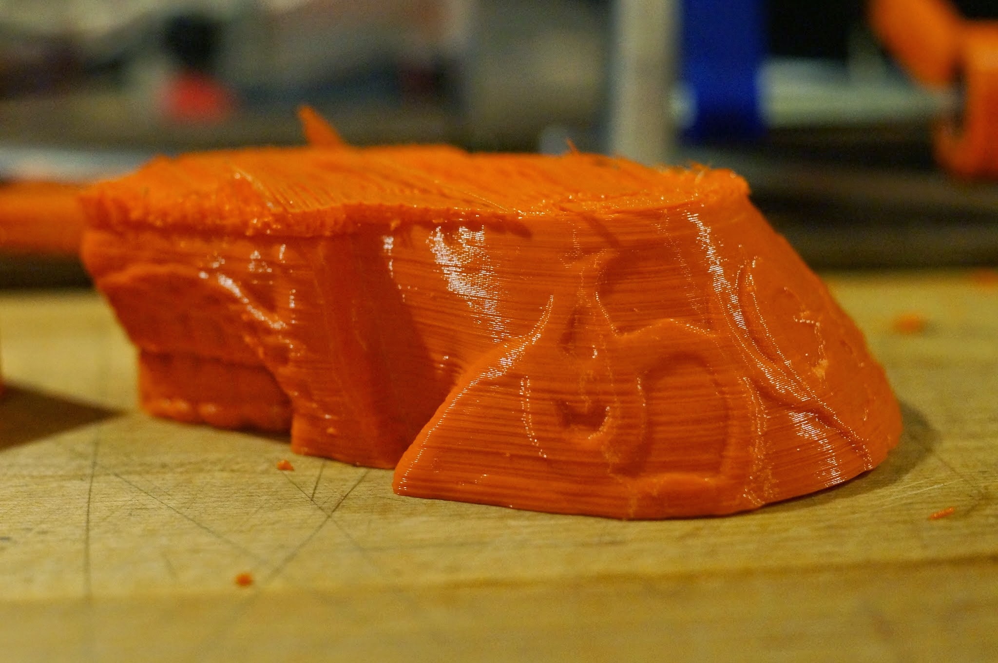

I just cannot get over how close this thing is to dialed in. This is prints 6 and 7 (total, including failures to start)…6 stopped when it did because a pulley came of. (That kinda messes up the ability to restart.)
I’ll put out an overall video update in a week or so, in the meantime, Sláinte!
I’ll grab the torture test (lots of retractions)
And give it a shot.
I AM noticing some lateral walking on the igus bushings…movement in X can be seen as tiny movements you can see in the Y direction by looking at the gaps in the bushing.
I am, but the problem (so far) seems to be related to one missing clamp, that was allowing a shaft to walk left and right slightly. And I can’t put one where it needs to be because my clamps are too thick. No big deal, I’ll just take a little off on the mill.
Now the pan-headed set-screw is too big. I briefly considered turning the pan-head off…then decided I’d stop by fastenal for a grub screw on the way home.
Tolerances are pretty critical in this design, if everything held tightly in all the right planes, I’m hoping it draws correct circles…It cannot print the smallest hole on this http://www.thingiverse.com/thing:33902
Maybe, it might also just be learning to work within the parameters that igus presents. The slop in my z-stage is abhorrent…but if you add a little Z-lift on move, it’s predictable and consistent.
