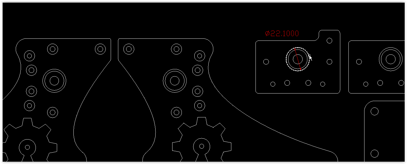

Mind sharing where you are seeing that dimension? Picture and file?
For the R7z, from Colin’s google drive @ https://drive.google.com/drive/folders/1FX5XazvT9ItUI95aqDxH0pj5qSuOnfE7
For the R7, I measured directly:
I adjusted my tool paths to cut 20.04mm by changing the “material to leave” parameter to a negative number. I did this cut at the drawing dimension then measured and cut again to make sure the bearings were snug fit. Not quite press fit but tighter than slip fit.
@Colin_Kaminski Thanks that makes sense now. I redid all the toolpaths to cut one plate at a time as well as switch to a 1/8 bit. I did not notice the material to leave parameter so left that off. The reamer made it fit fine, just wanted to make sure I wasn’t missing something with my pocket being slightly smaller.
I just looked, the original model has it at 22.1mm. Same with the DXF plate files Brandon made available back in the beta phase.
