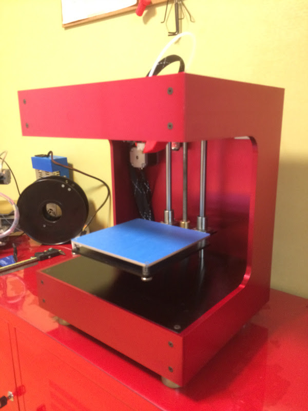

I just finished building my new H-bot 3D printer.
Designing enclosure was great challenge for me, and I come to know it is very difficult to design stylish cases without enough experiences. This time, I just wanted to build robust and solid printer. It is not perfect aesthetically, but quite good for me.
Now it is time for ignite engine.
Originally shared by DongWon Han (DWONH)
Recently, I managed to assemble my new 3D printer.
It has H-bot style cartesian plane and made of all anodized aluminum.
It is simple, not unique design, I got design idea over many well known printers as reference.
Though it is not fully tested yet, I’d like enjoy the moment of achievement now.
Even I spent some months in design, I can see many things that has to be changed or improved. Hotend carrier together with belt tension mechanism needs to be improved, maybe closed timing belt is a good option. And need to find smart and neat design to attach heated bed, also possible use of ribbon cables.
Anyway, this is first 3D printer that has ‘machine-like’ look. though 3rd printer I designed.
Dimensions: 320(W) X 284(D) X 405(H)
Build volume: 150 X 150 X 150
Clean, with linear rails too. Good job!
This is awesome! Very nice looking design.
Looks great! Really nice job. I’m looking forward to seeing some prints off of this design.

This is very impressive work.
Thank you for compliments
@DongWon_Han_DWONH will you release any plans for it? Also did you anodize the aluminum yourself? I know you can buy a red anodizing spraypaint that gives a pretty realistic look so I was just curious. Thanks!
@Griffin_Paquette Before I make any decisions, this design must be improved quite bit, I don’t like belt tension mechanism and hotend carriage. More than that I have to confirm this design can print precisely or not.
As for the anodizing, I just design parts and order machining and anodizing, I can access some machine shops easily.
