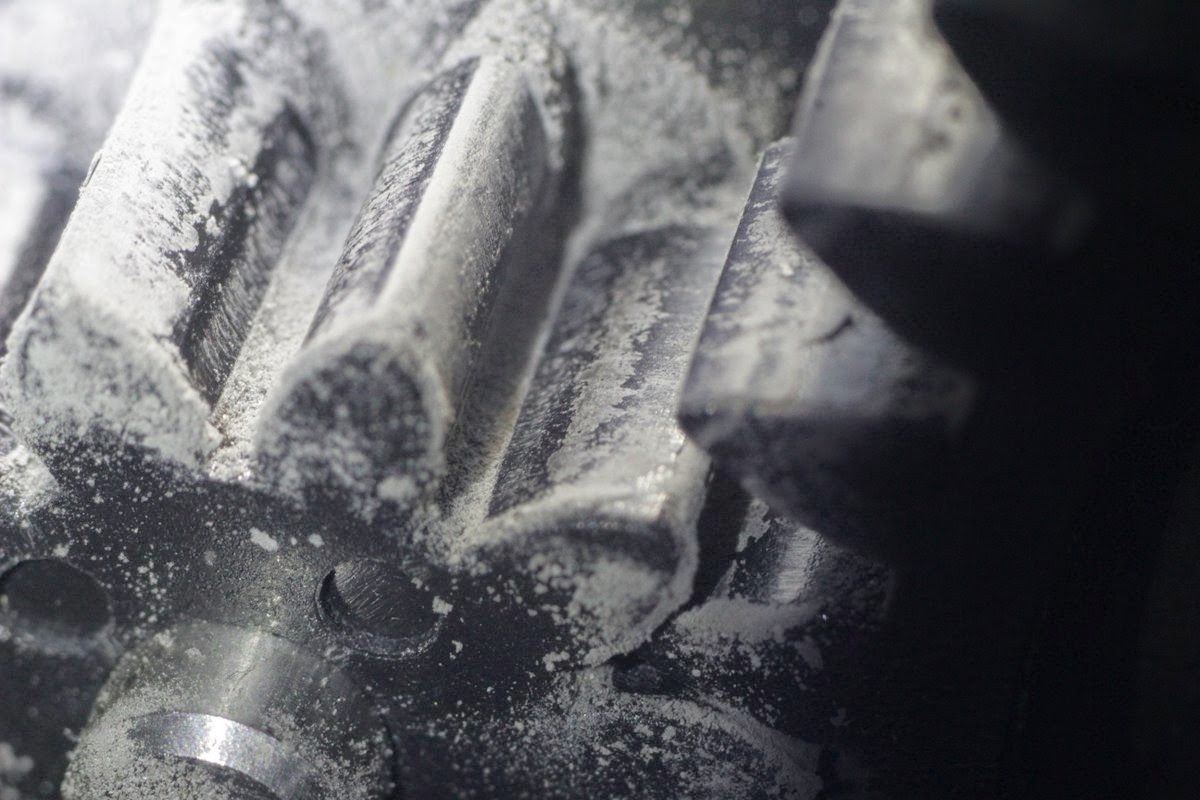

Also, is it normal for the extruder gear to produce so much dust? It literally rains on the print, look at the pictures! :slight_smile:

Well, at least you have nice, smooth interfacing surfaces on the gears now…
There’s probably too much tension on the gears, I’d loosen them up a bit. Also, unless some of that dust is a dry lubricant that was put there intensionally, you could probably use some lubrication. My instinct would be to go with a grease lubricant, either lithium or silicone, but I don’t really use plastic gears, so somebody else might have a better idea.
Have you lubricated your extruder gears? Other than that all I can think of is that they still need some wearing in.
Dust in gears - ouch. Do you have a way of moving the gears apart a bit? This could ease the pressure that grinds them. If you can, ease the fastening of the motor/small gear and have it rotate freely some humdreds of mms in both directions - observe any uneven behavior that could mean you got an oval gear :slight_smile: Dunno if it’s possible on gears of industrial make. Otherwise, there is a chance they will rub between themselves until their contact is good enough, but more likely they will fall apart first - better print some spare ones out of PLA :slight_smile:

I use beeswax for stuff like this. It’s kinda seems low-tech but it works and isn’t messy.
I know that feel bro
2nd the beeswax on plastic gears. I’ve used 3 in 1 oil as well, which works but doesn’t last very long.
2nd the lithium grease for everything. As opposed to beeswax (or WD40-stlye oils) it’s a proper lubricant and also sticky enough to hold on to any worn-off particles.
I have no beeswax, so I used some ElectroLube (it’s a ‘plastic lubricant’ grease). No more dust (or at least it gets absorbed by the grease). Also lubing the z-spindle seems to have yielded success (after a while). The Magnalube in threads looks real dirty, but movement is much smoother now. The bearings also dont seem to get stuck any more (for whatever reason).
