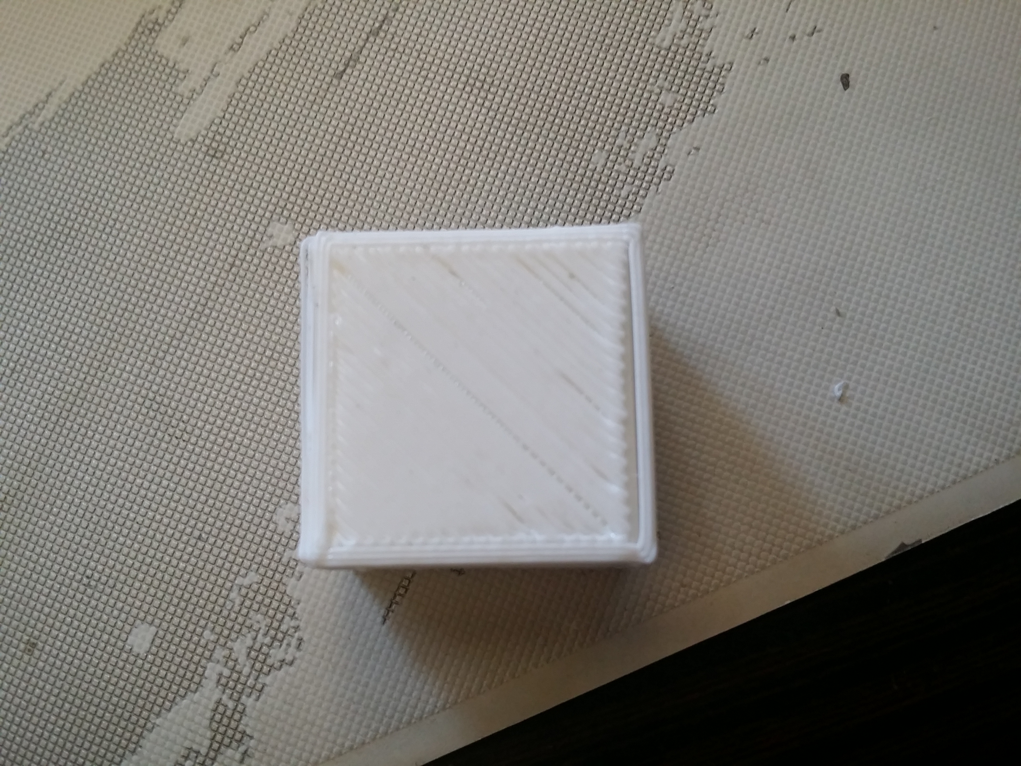

I just got a Printrbot Metal plus and I'm having trouble with my print
I just got a Printrbot Metal plus and I’m having trouble with my print quality.
I’m useing slicer and I have all ready tightened my belts, and calibrated my exstruders steps per mm.
My hot end is set at 210 c for pla and my bed temp at 70 c , any help on resolving these print issues would be greatly appreciated.
Thanks in advance.
I know you’ve said you tightened your belts, but have you checked the pulley set screws? This looks kind of random, which is usually indicative of something slipping - I’d look there first.
Make sure you go through this process as well: http://reprap.org/wiki/Triffid_Hunter's_Calibration_Guide
210 seems a little hot for PLA, try 200 and maybe 55 - 60 for bed temp, can always print first layer slightly hotter if you have adhesion problems
Thank you I will take a look at them
Thanks guys it was the pulley set screw. I really appreciate the help.
