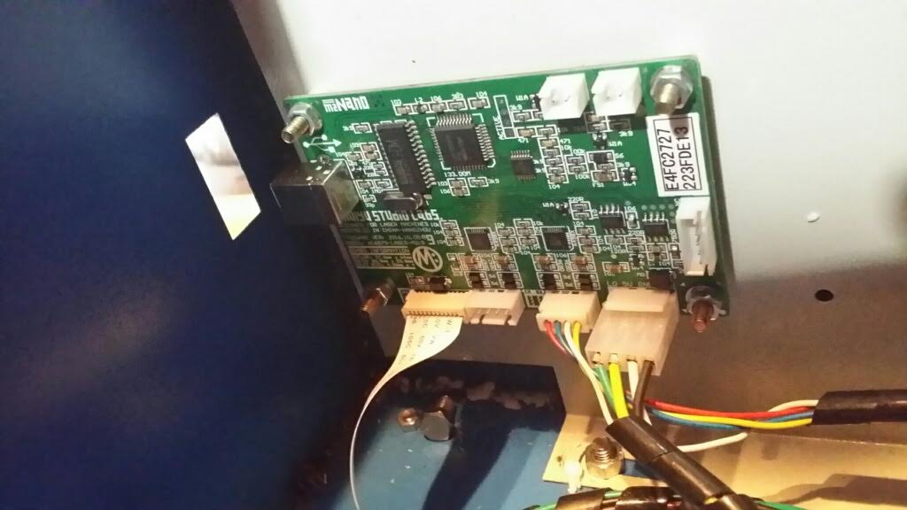

Also when your K40 arrives please post the connections to the original board if it’s the type without the ribbon cable might be easier to upgrade

@raykholo Hello, My K40 arrived today and this was the board that came with my unit. Any suggestions on which board I should order?
I see ribbon cable. Get the mini, no question. GLCD Adapter and additional drivers as we discussed above.
