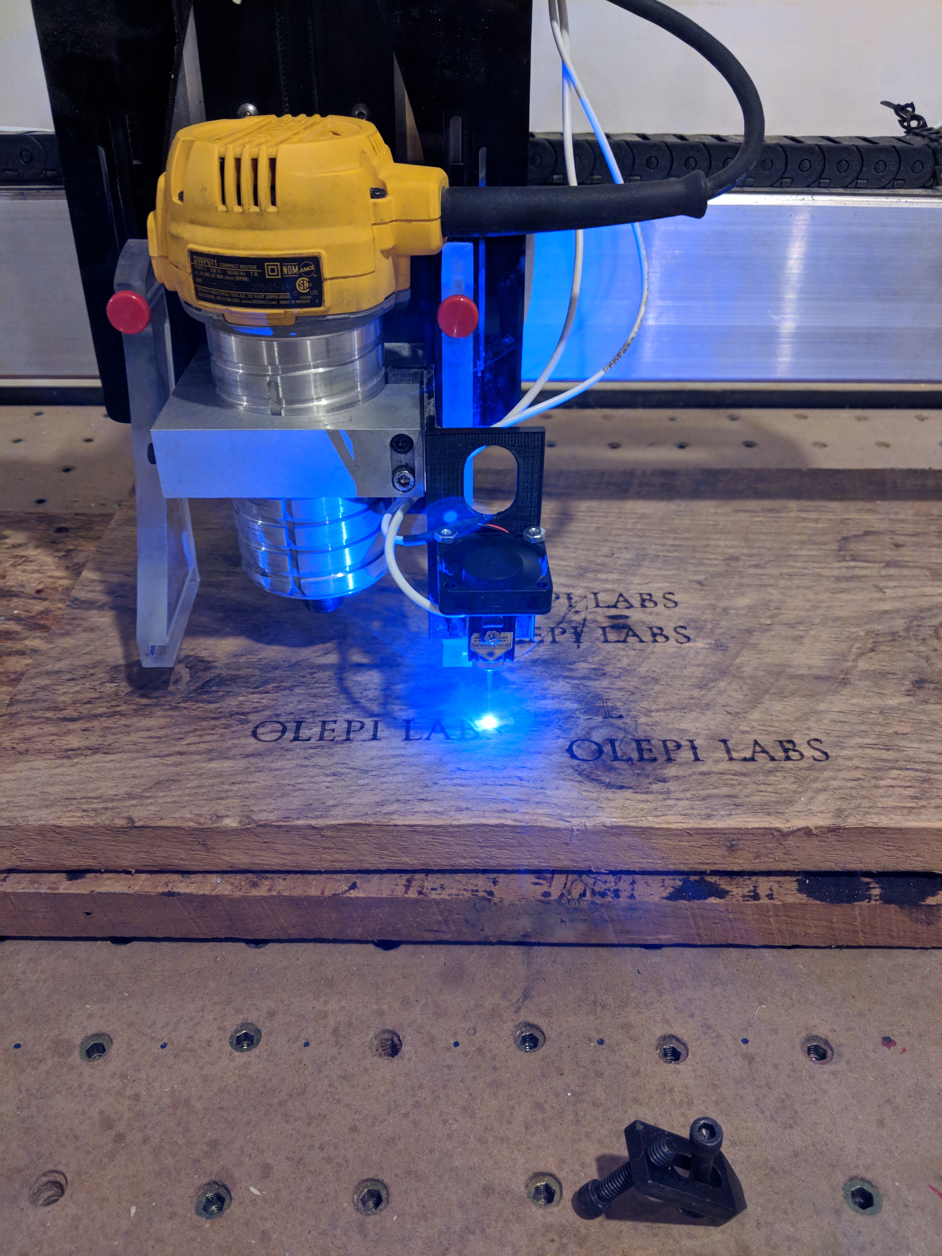

I just picked up a 3.8w laser kit for my shapeoko xxl and thinking
I just picked up a 3.8w laser kit for my shapeoko xxl and thinking about trying out laserweb. Any other users have a shapeoko? If so do you have any recomendations as far as settings etc…
