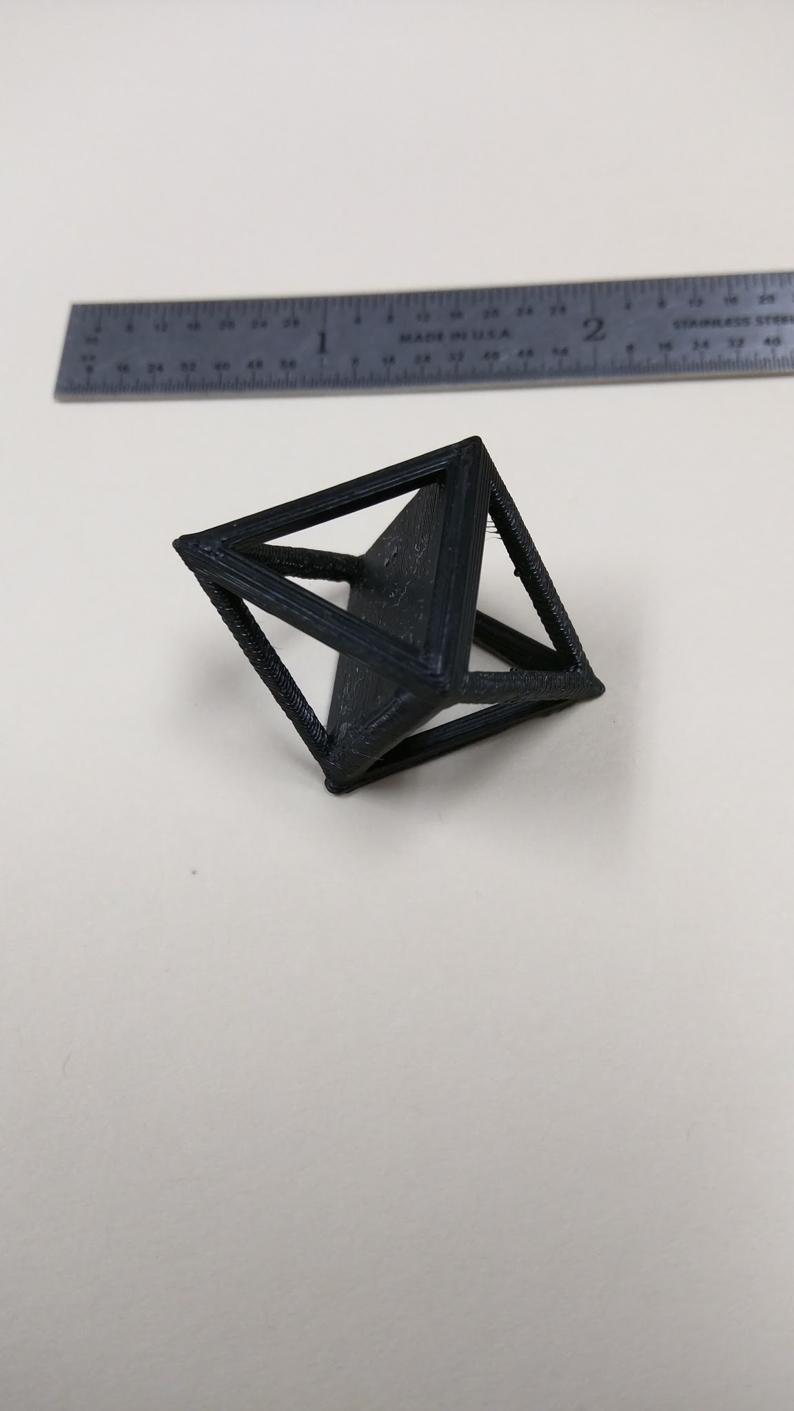

I just posted my configs for my Rostock Max V2 on the Thing Redeem forum. They have been working for me.

Okay, not as similar as I had hoped. But it looks like yours is printing okay!
