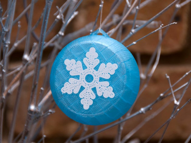

And here are four Christmas Tree Baubles that are printed using the same technique. Merry Christmas :slight_smile:
