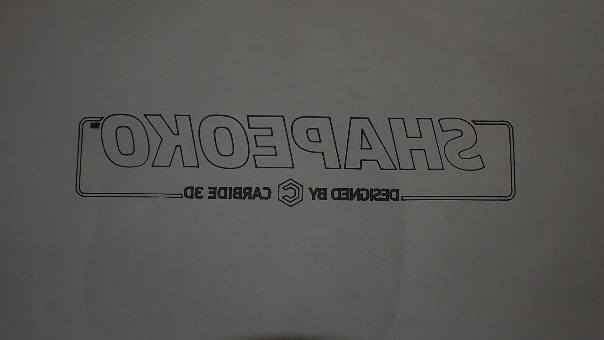

I just ran a hello world project on my shapeoko 3. http://docs.carbide3d.com/article/37-shapeoko-3-hello-world
Can someone enplane why it is doing this?
Your X axes is inverted. You can change it in your motor controller (GRBL has a command for inverting the outputs I think) or you could swap how the coils in the stepper are wired to the controller.
EDIT: I had originally said both x and y were reversed, but i was wrong
Looks like just the x axis is backwards. I believe it is $6 on my GRBL version.

so what if i reverse two of the wires on the x and y stepper motors?
I know hardly anything about cnc machine and gcode so you all will have to give me the simple version:)
Please see: http://docs.carbide3d.com/article/38-shapeoko-3-default-grbl-settings
It has instructions at the bottom for checking your settings and a list of all the correct defaults. You can compare to see if an x-axis related setting is screwy and then set it to the proper value.

The easiest thing to do is reverse the Black and Green wires on the X Axis motor. Thats a great to do Logos for the front of an Ambulance LOL.
@Michael_Omiccioli
thanks that is probably what I will do sound easy:)
Physically swapping wires is probably not the best idea because then you don’t have the default hardware configuration anymore. It might cause problems when Carbide upgrades firmware, software, etc.
I would suggest tweaking the stepper direction mask to simply “flip a bit” and invert the direction through a mutable settings change.
See: http://www.shapeoko.com/wiki/index.php/Grbl#Invert_Bits
Should be the $3 setting for the version of GRBL the SO3 uses…but see the info in the above link for specifics.
@Craig_The_Fabricator
thanks will do

Let’s try to invert the X axis…according to the table, we would set $3=7 (it’s currently set to 6 on yours)- this should leave the Y and Z as-is and swap the X around.
thanks running hello world now and it looks perfect
Excellent. Glad we got it worked out. I would still love to understand the “why,” but at least it’s resolved and you didn’t have to fuss with the hardware any.
