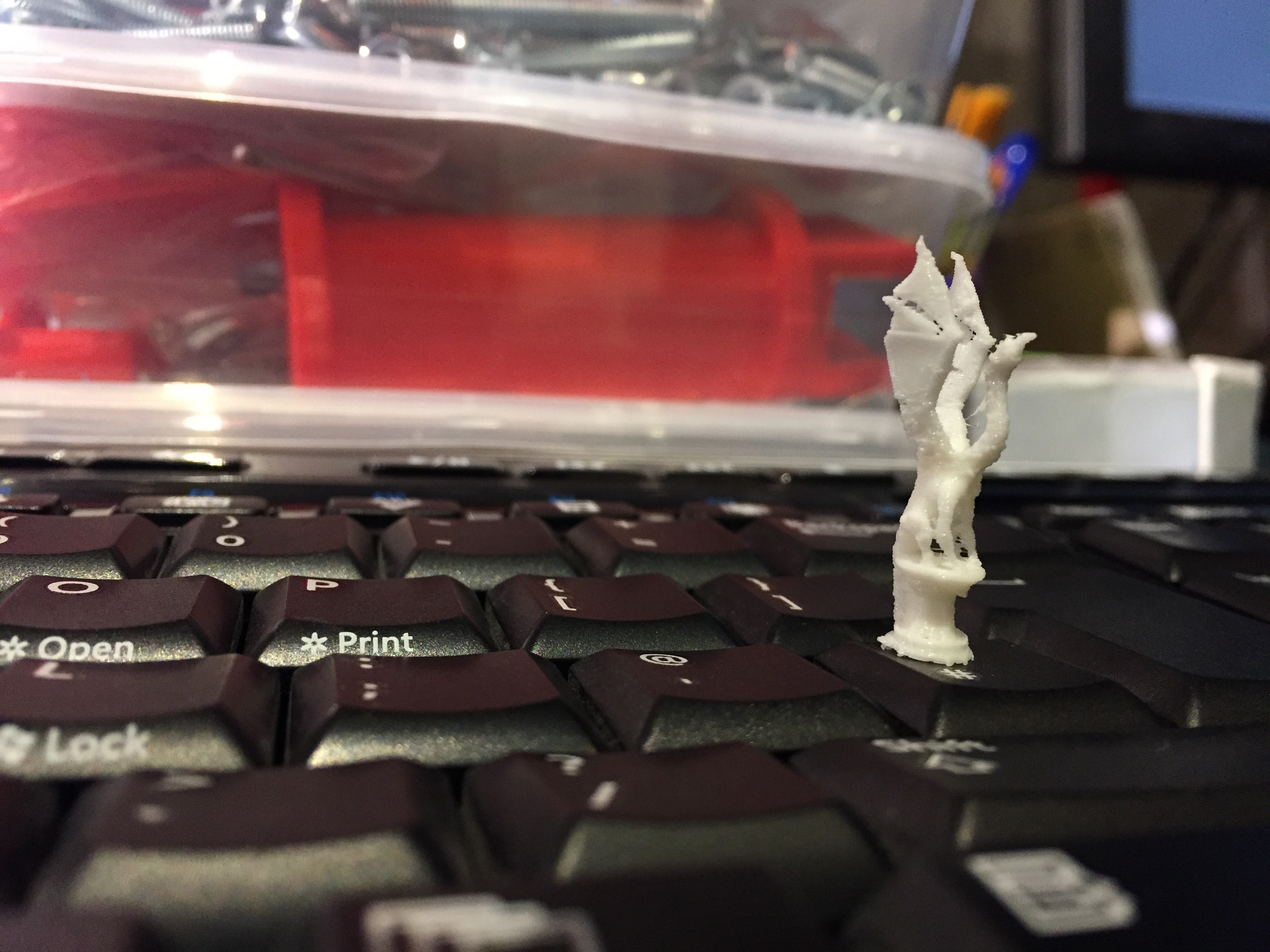

I just realised there's a faster to print model for my tests with .1
I just realised there’s a faster to print model for my tests with .1 layers, detail and mass cooling than the little UltiMaker robot. Shame I don’t have a macro lens that can let you all see just how well this little Aria came out, the photo really doesn’t do it justice. Nice one @Louise_Driggers !
Scaled down in Netfabb Basic, 0.2 something to give a height of 29.92mm. And not hard at all. It was fingers crossed all the way that it wouldn’t blow away from the cooling fan blast!

@Dat_Chu the photo doesn’t do it justice, but this is how small I managed to take Louise’s dragon with LOTS of extra cooling. And I think extreme overhang needs the same help.
