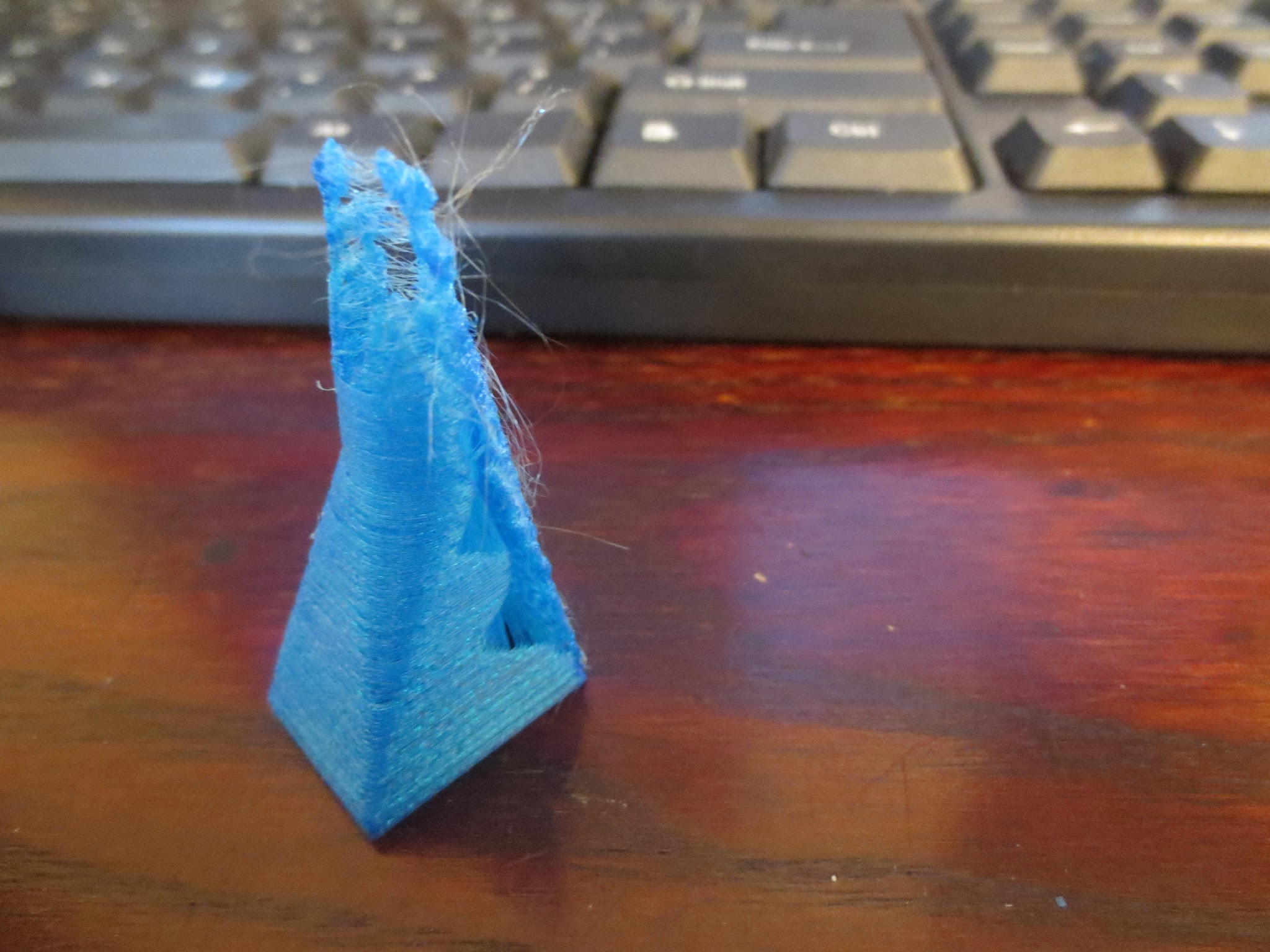

I just swapped my j-head for an e3d v6 and there are a few
I just swapped my j-head for an e3d v6 and there are a few problems here. I had to increase the tension on the hobbed bolt as high as it would go to get smooth extrusion and that tells me that something is probably wrong. The holes in the 2-wall blower nozzle are interesting. Thoughts?
makerfarm prusa i3
3mm pla @ 210
0.4mm nozzle

Oh yeah didn’t see the last picture of the hotend. With all metal hotends you MUST run a fan and most with a shroud. I have two ubis all metal hotends and they are the same way. You are most likely getting severe heat creep that is making the filament heat up and expand in the peek of the hotend. It happened with my first jhead lite and just having a fan like you have didn’t solve it.

Ok I reported back too early. It is improved and I just got the best print since switching hotends and possibly since before, but I did still need to tighten the idler down on the hobbed bolt all the way. Could it just be that 3mm filament is harder to heat when heat does not creep up into the cold side?
@Matt_Harrington It’s because you aren’t using the correct barrel cooling mechanism. It is absolutely essential to use not only the provided fan but the shroud designed for it as well. The v6 all metal uses the fan and shroud as an integral part of the design and the heat creep is what you are seeing by not properly cooling the barrel. By not using the proper parts you are asking for issues and it may never likely work properly.
