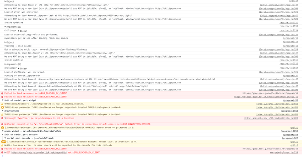

@John_Hornsby-Hunt try hitting F12, then look for a tab named sth. like Console.
First picture is the console when the error occurs, and in the second picture is the console when it’s working correctly. Very interesting: I could fix the problem by switching to Incognito mode. So I cleared my cache and now it’s working again. I’ll try to find out under what circumstances the error reoccurs.
