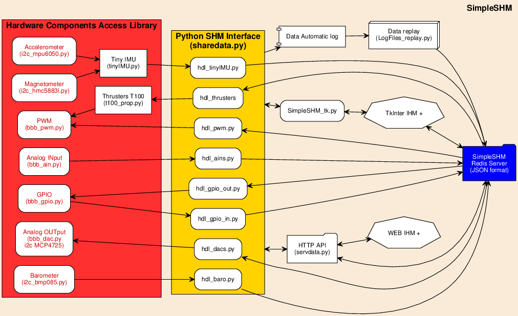

My process exchange data via Redis streams (http://antirez.com/news/114) and what is not data oriented (like init or low level security, e.g. action oriented) is via xml-rpc, which is not perfect but very well supported and rather simple too.

@clolsonus Yes Redis is the main component of my architecture (and I don’t have to maintain it), I tried first with my own solution like you, but mine were not sturdy enough for my needs, so I experienced with spreads, memcached, redis since 2014 and now with the new stream data support in soon to be released Redis 5.0.
My journey is a little similar to yours and I capitalize on my previous works too.
Today I love Python because It allows me to write all the tools around the main core (and the main core for now) like a launcher, a grapher (with graphviz) for the workflow of the data connected process, I can automate a lot of things pertaining to the software quality department.

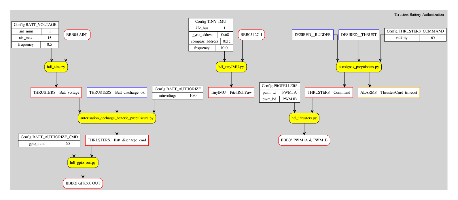

@clolsonus
and a simple application example.
I stil have to publish a working version on github, but I keep modifying and changing some main components (for three years now, what a mess !), as you understand it is much of a research/studying process for me.
