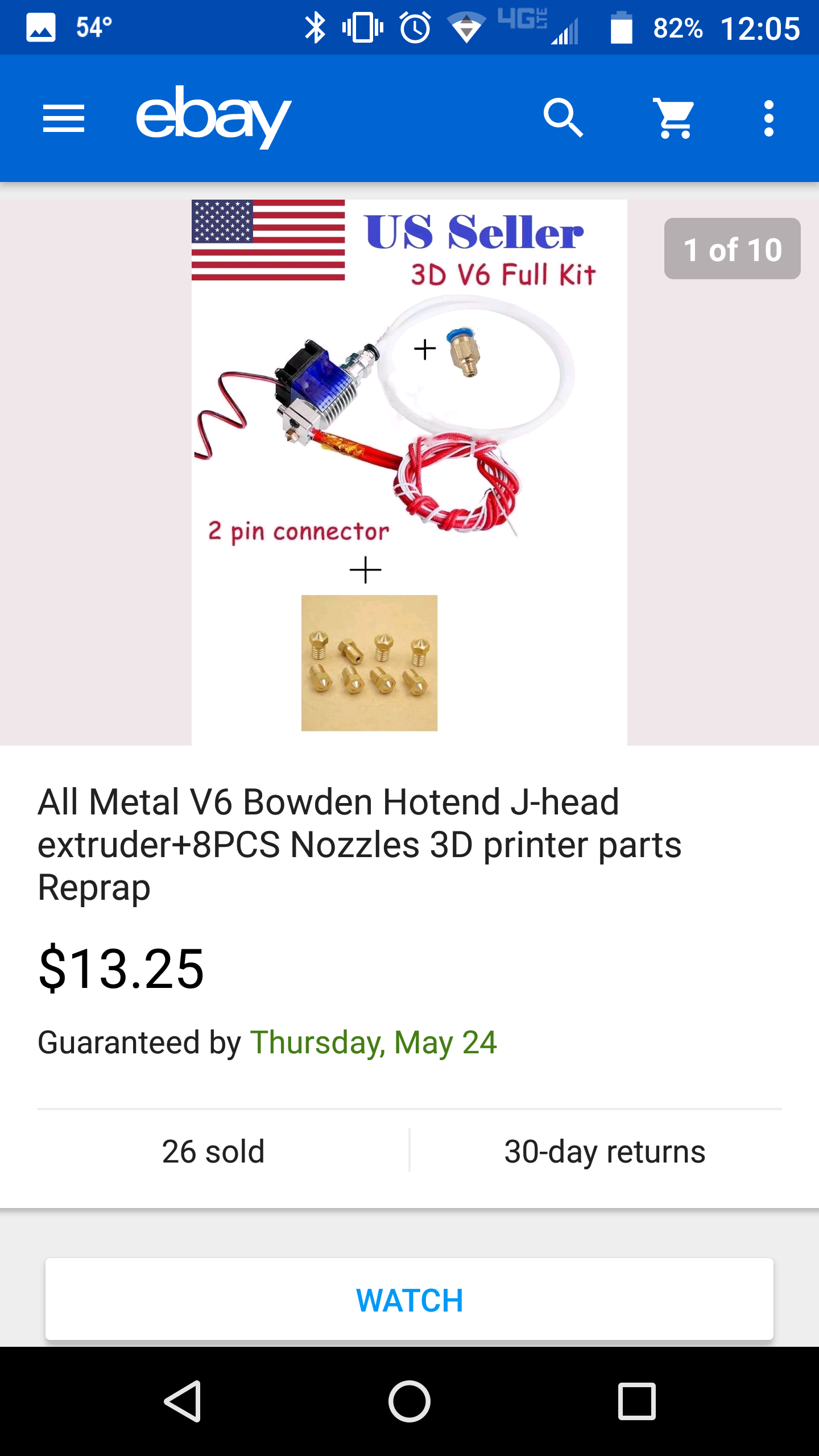

I know a few of you guys said not to buy this but I also know a few of you print a lot and are willing to spend the money on a real E3D hot end. However, I decided to get one of these anyway because it was cheap. Well to my surprise, it’s actually working great! $13.25 for everything in the picture and I haven’t had a single jam yet. I’m sure there may be some issue lurking around the corner but I’ll deal with that if it ever comes. But for now, this cheap Chinese knock off is doing great. Also, one thing that was mentioned online is that the only part of this hot end that may be an issue is the heat break if it’s not machined properly. That part is replaceable so even if I had gotten a bad one, it would be easy and cheap enough to get a new one. Overall I’m satisfied with my purchase. I did however use all my old components. The heater, thermistor, cooling fan and part cooling fan are all stock. I did have to print an adapter to go from the 30mm fan to a 40mm fan though. I didn’t want to re-wire everything. Lol. It works great and saved me a bunch of money.
Well, most of the Chinese knock-offs don’t have the precisely engineered internal surface finish and crucially, they have a little PTFE right near the nozzle thereby limiting the maximum temperature. I can’t say I reccomend them even if they do work for some plastics. Also, watch out for the pipe coupling on top standing proud which is fine for a Bowden setup but doesn’t fit with some other kit.
the only problem these things have besides the ptfe lining is that the nozzle and heat break dont mate very well and it tends to leak after some time… if possible lap the two surfaces before you use this or just look out for leaks. Also the nozzle diameters tend to vary … so a 0.4mm is not actually a 0.4mm … this throws of calibration.

This has ptfe all the way to the tip, and they are fraudulently using the J-head trademark. Don’t buy this stuff.

@Duncan_Gunn @ekaggrat_singh_kalsi @ThantiK actually this doesn’t have any tubing near the nozzel. It stops at the heat break. I couldn’t put tubing in there if I wanted to. It’s part of the reason I got it. I know some of you guys are really serious about printing but I just do it for fun as a side hobby. This was cheap and it’s working great. I just ran a 3.5 hour print last night and it came out looking great. I know the quality isn’t as good but it does what I need it to and I don’t have the extra cash for all the nice expensive stuff. I have bills and other hobbies as well. Plus, I only print with PLA anyway so even if it did have tubing all the way to the nozzel, it wouldn’t matter to me.

PLA is actually the biggest problem for knock-off all-metal hot ends. For PLA with knock-offs, you WANT the PTFE liner. It’s more forgiving. This hot end might work just fine until you do a 20 hour print with a lot of retraction and short extrusion moves near the end, or it might work fine as long as your house is below X temperature, or the filament has less than Y% pigment load… In the long run you’ll probably burn as much money on filament doing reprints while troubleshooting it as you saved on the hot end…
