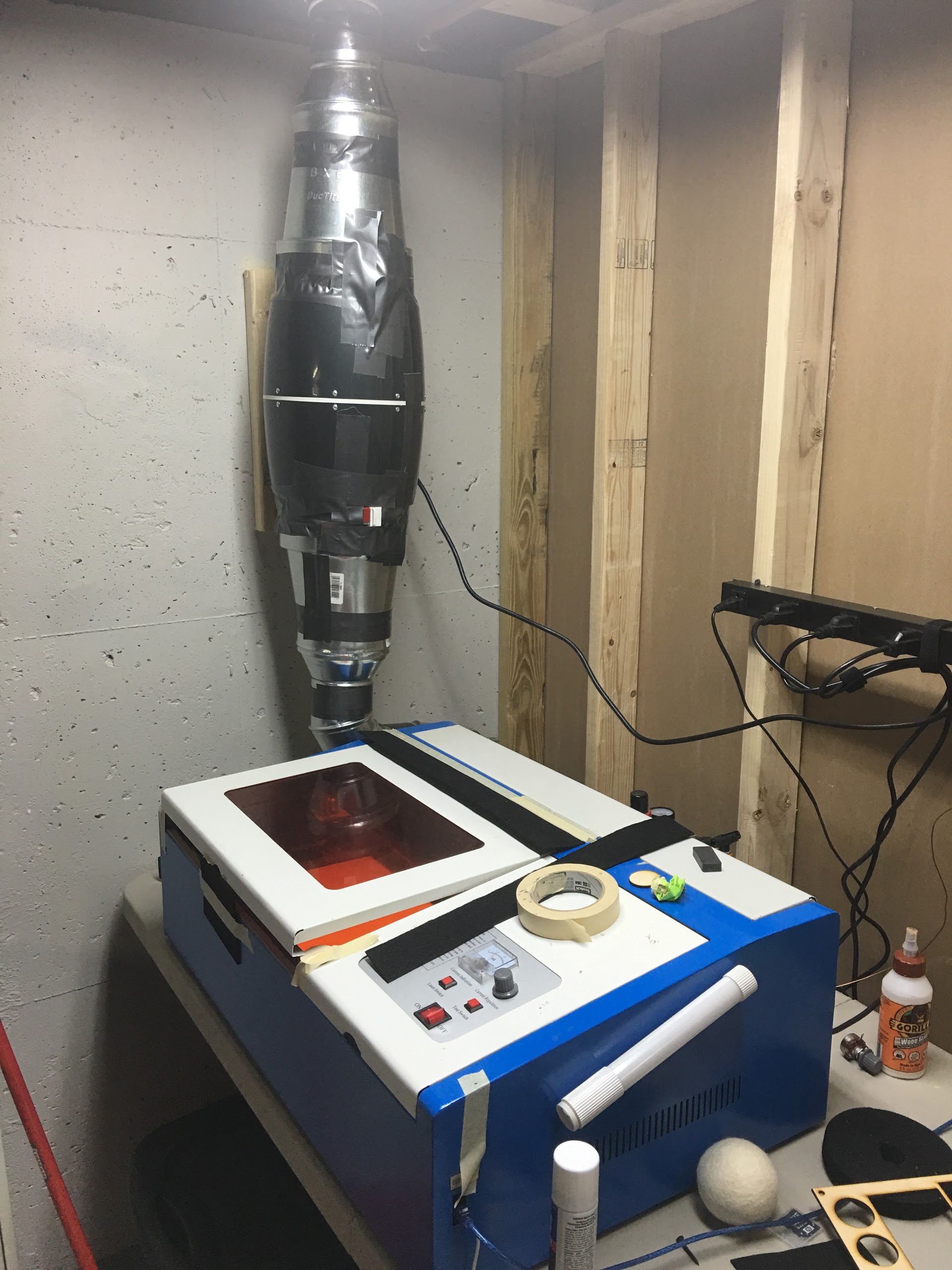

I know I have asked this before and have gotten some good advise to reduce the fumes coming from my machine but I still get odors and find myself yet again wondering if I am harming myself wife and kids with the fumes as my laser cutter is in the basement I am thinking about cutting a fresh air intake in the side of my house aka another dryer vent and cutting a fresh air intake into the side of the machine then trying to seal the thing up air tight but I don’t know if that is realistic or will solve the problem any thoughts and advise would be great
Not practical - too many opening
The problem is that you have the positive-pressure side inside the room. That blower needs to have everything on the pressure side, outside. All of it. The only thing you should have inside your home is the suction side of things.

@ThantiK so the blower should be outside my house? That could be possible I might be able to build a box water prop it and set it up on the outside Of my house
Can someone explain to me the whole negative pressure thing I am not getting what is meant by that or how to accomplish it in my work area I think another problem is that I have it near my heat and AC unit
@3D_Laser ​, on the blower there are two sides. One side has vacuum (negative pressure), the other has positive pressure. Any portion of your ducting that’s on the positive pressure side, will expel fumes from wherever it can. Any hole, any crack, any crevice. If those portions of the ducting are inside your home, you WILL get fumes unless you’re perfectly sealed, and nobody ever gets a perfect seal at all joints. However, if all of those joints are on the vacuum side, it will just pull a small amount of air out of the house instead. Leaving you with no fumes.
