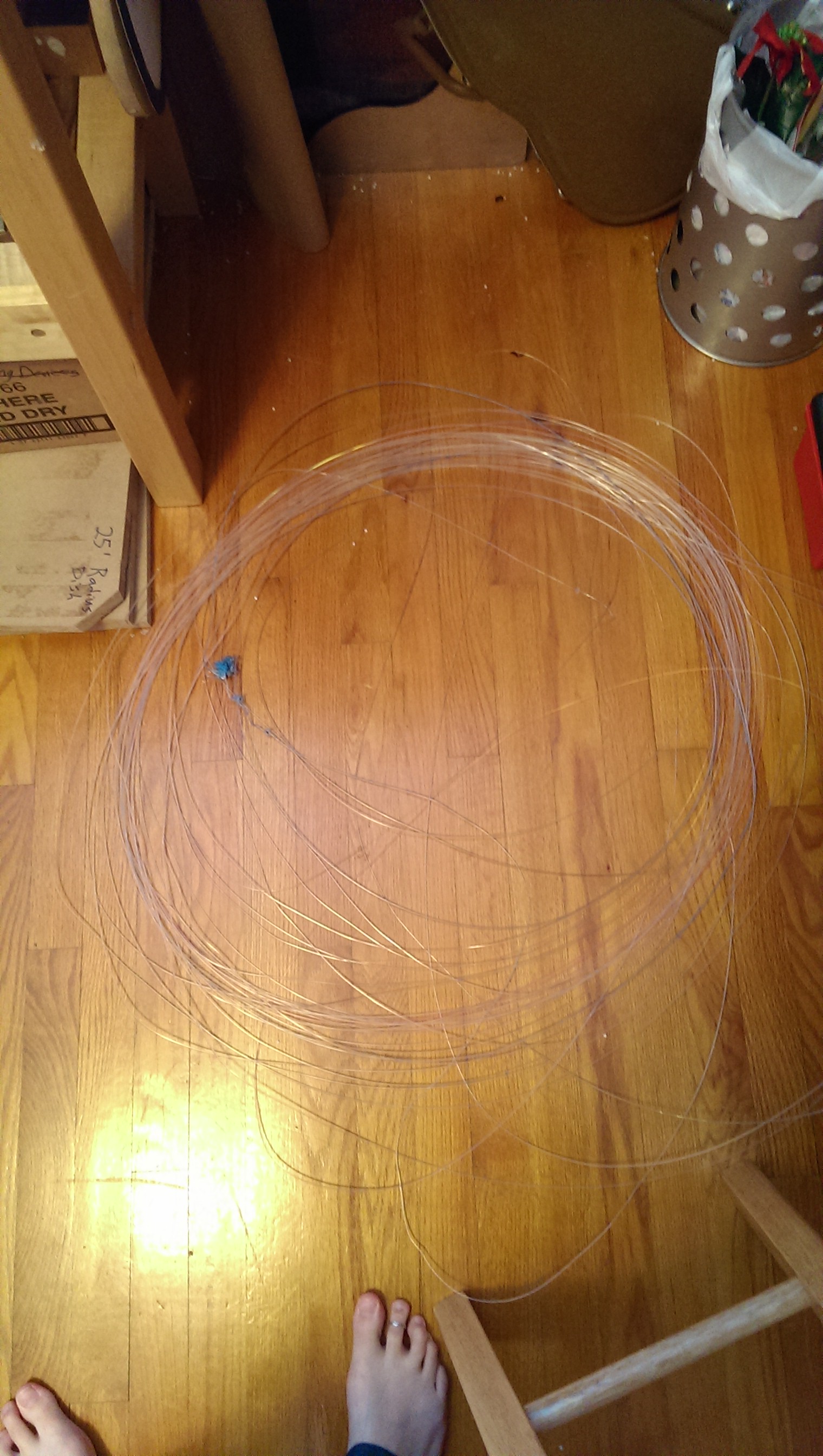

I know it doesn't look like much but PLA filastruding for the win! After
I know it doesn’t look like much but PLA filastruding for the win! After all the trouble we had with ABS we are very encouraged!
Tell us how the prints come out, and the quality of the filament when you can. I’m pretty interested in recycling prints.
We’re actually still cleaning out our metal shavings from the auger so we’re not going to use this. We had such a large plug in the ABS that we had to take the nozzle off and start again. And we’re taking the opportunity to add a few color pellets just for fun :wink: So far all we’ve heard is that PLA is more difficult than ABS in both extruding and printing but we’ve found nothing but the opposite - PLA had been easier for us in both accounts. When we get to printing with our extruded products I’ll let you know.
