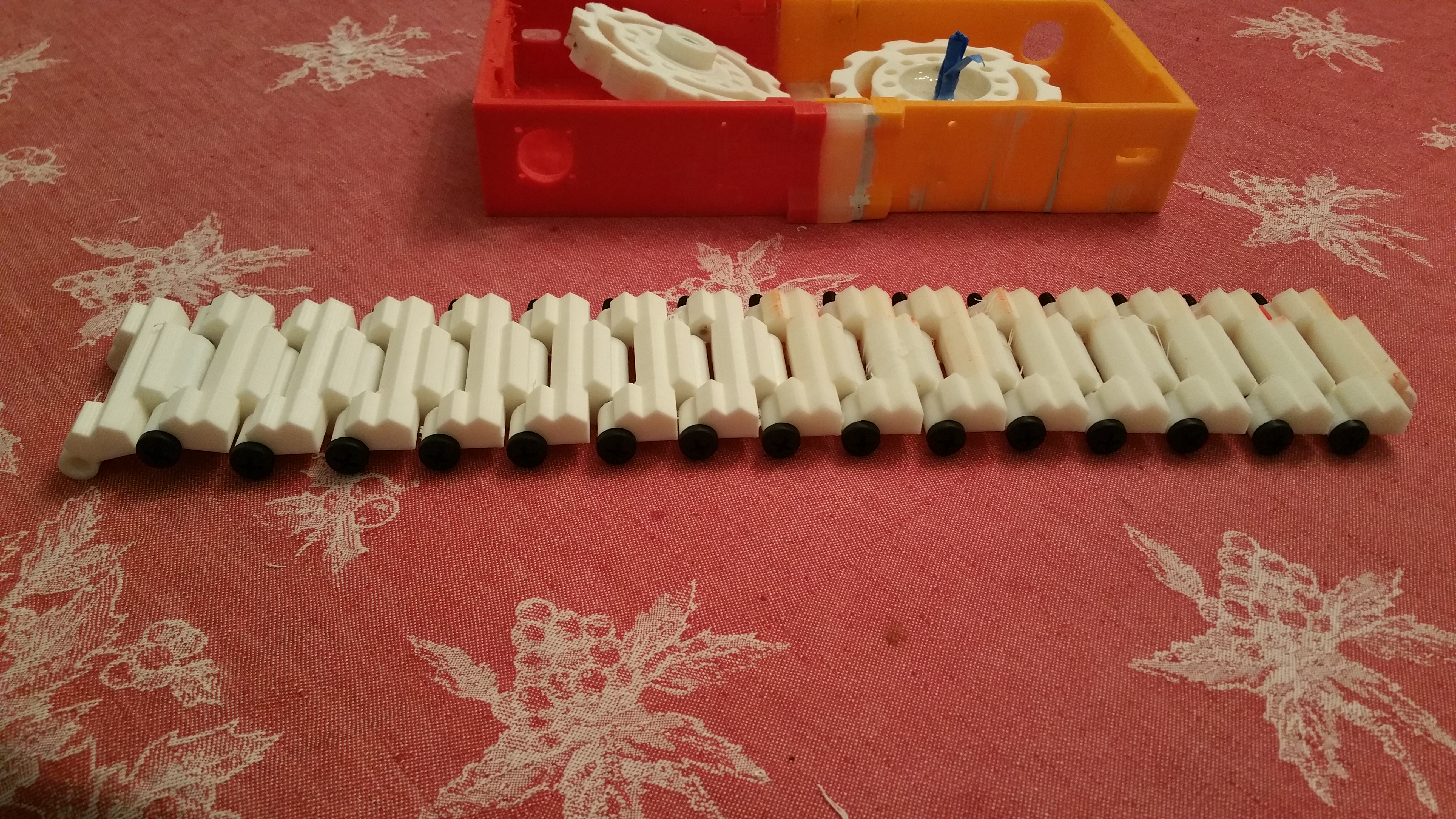

I know some of you have been following my progress on the Printrbot Tank
I know some of you have been following my progress on the Printrbot Tank retrofit (thanks again @Brook_Drumm1 ​). As you know I could not get the provided tread to print on any printer I have because nothing I have is bigger than 200mmx200mm. So that meant I had to ditch the wheels and wheel covers. I found this sprocket and tread set on Thingiverse and scaled everything up to 161%. That gave me an M6 sized hole in the treads. Amazon provided M6x70mm nylon screws and nuts. Perfect! I love the color effect. The treads are printed 8 at a time standing vertically so that the sprockets don’t rip them apart under load. I had previously estimated 30 links per side, Md it appears I will need 28. Talk about a Mark I Eyeball! The fit is terrific. I did minimal cleanup because that’s what wear and tear will do and ridges will just add to traction. This baby is getting my nerf 12 shot gatling turret. It’s a beast!

Tom, check out my post with the Attacknid. That’s the turret. When done I will post the files. Wheel and track came from Thingiverse, Turret came from a robot arm base, motors and gearbox from Tamiya (I wanted to add speed control). I will park it all up there when done or… as I go along if others prefer.
