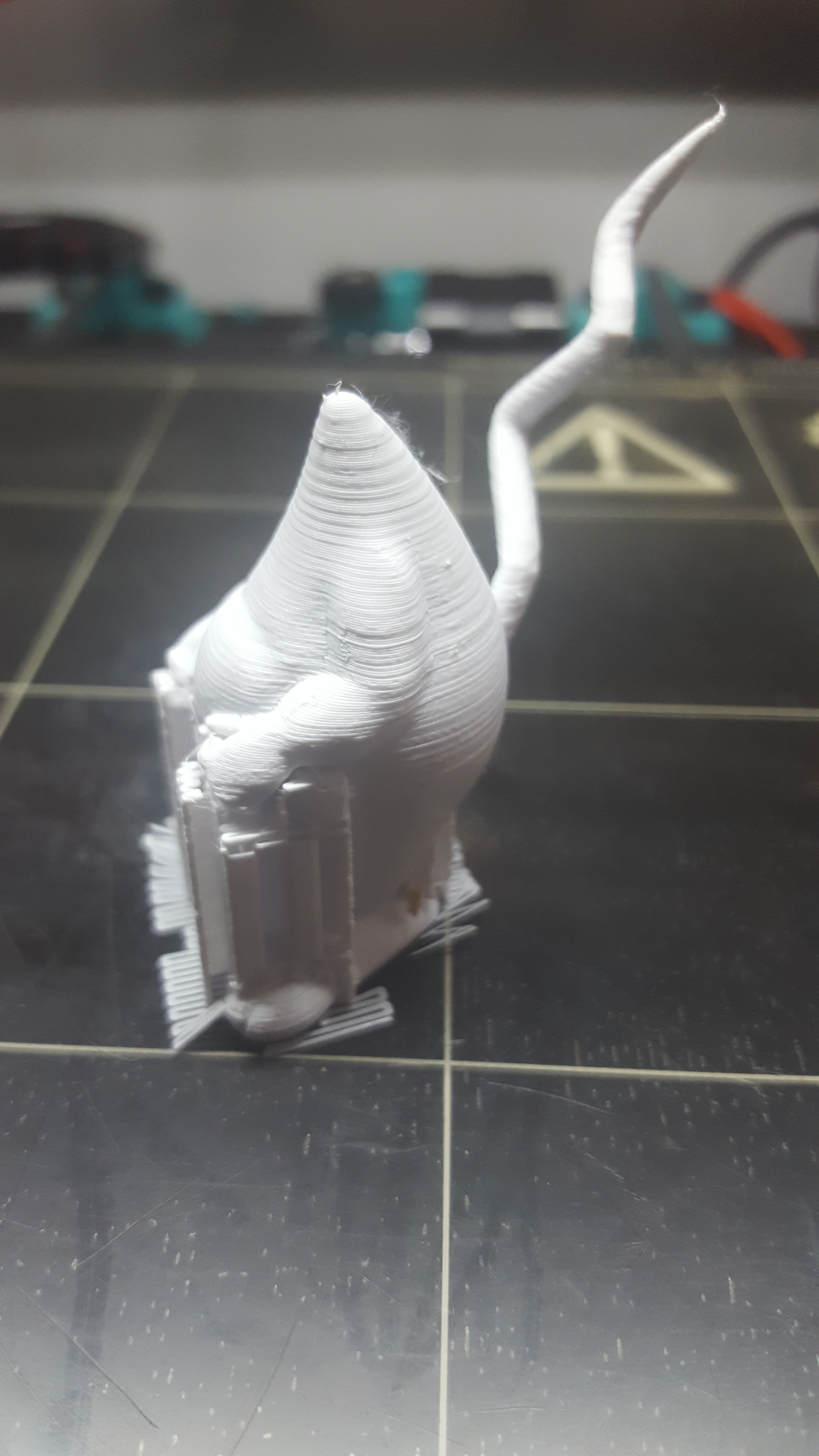

I know some of you here have built your printers from scratch so im hoping one of you will be able to shed some light on my current issue. I have some Z banding on my printer i cannot seem to figure out. It was originally an Prusa i3 MK2S but i changed it over to a 3030 aluminum extrusion frame. Everything ran fine for a few weeks but now everything i print looks like crap.

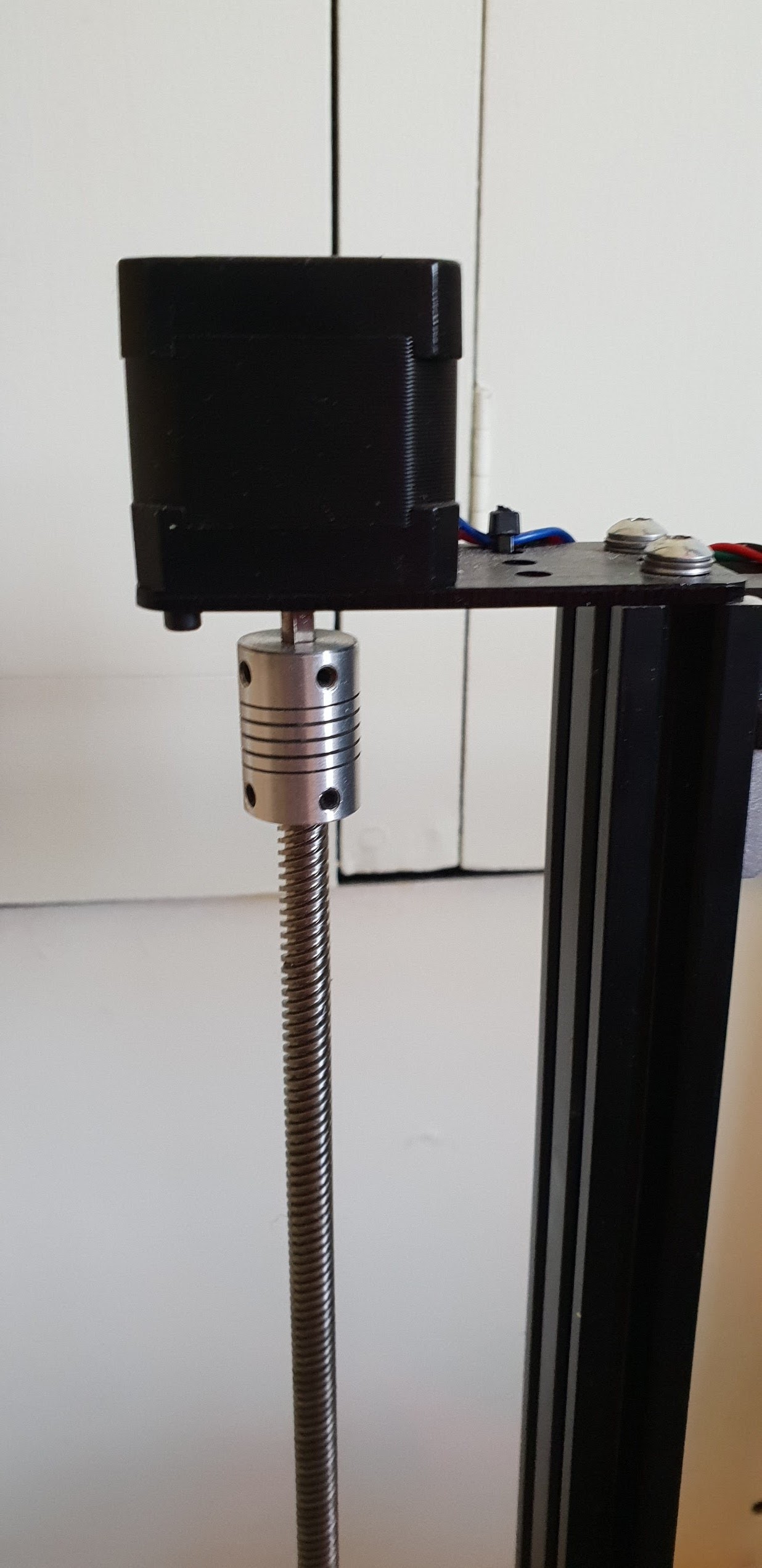

Have you got couplings on the z motors? Could be that their slightly misaligned??
Can you post a pic of your z axis?
Only one i have with me. I dont have couplings i use lead screwsmissing/deleted image from Google+
This is what i meant. It negates any slight differences in the threaded rod. Are your z screws directly attached to the steppers?

Try printing a calibration cube. Then you will be able to see if the banding happens on all axis or just z.
Maybe try changing your flow rate in your slicing software. It kinda looks like it’s under extruding. Have you tried a different nozzel or filament? Are you sure that your temps are accurate? Maybe your thermistor is reporting an incorrect temp and you’re running too cold.
@Jonathon_Thrumble the screws are built into the steppers yes

Check the vertical alignment on your lead screws. Are they the same distance from the frame on the top and bottom, or do they lean from left to right? Bent lead screws can also be a culprit. In your case that would involve replacement of the stepper motors as well.

  1. Over-extrusion will cause surface finish like this… try cutting your extrusion multiplier to ~80% of whatever it is now, just as a quick test to see if the appearance changes.
  2. White filament often has performance issues due to extremely high pigment load, and it shows flaws better than other colors too… try a different color (not black) to see if it looks any better.
