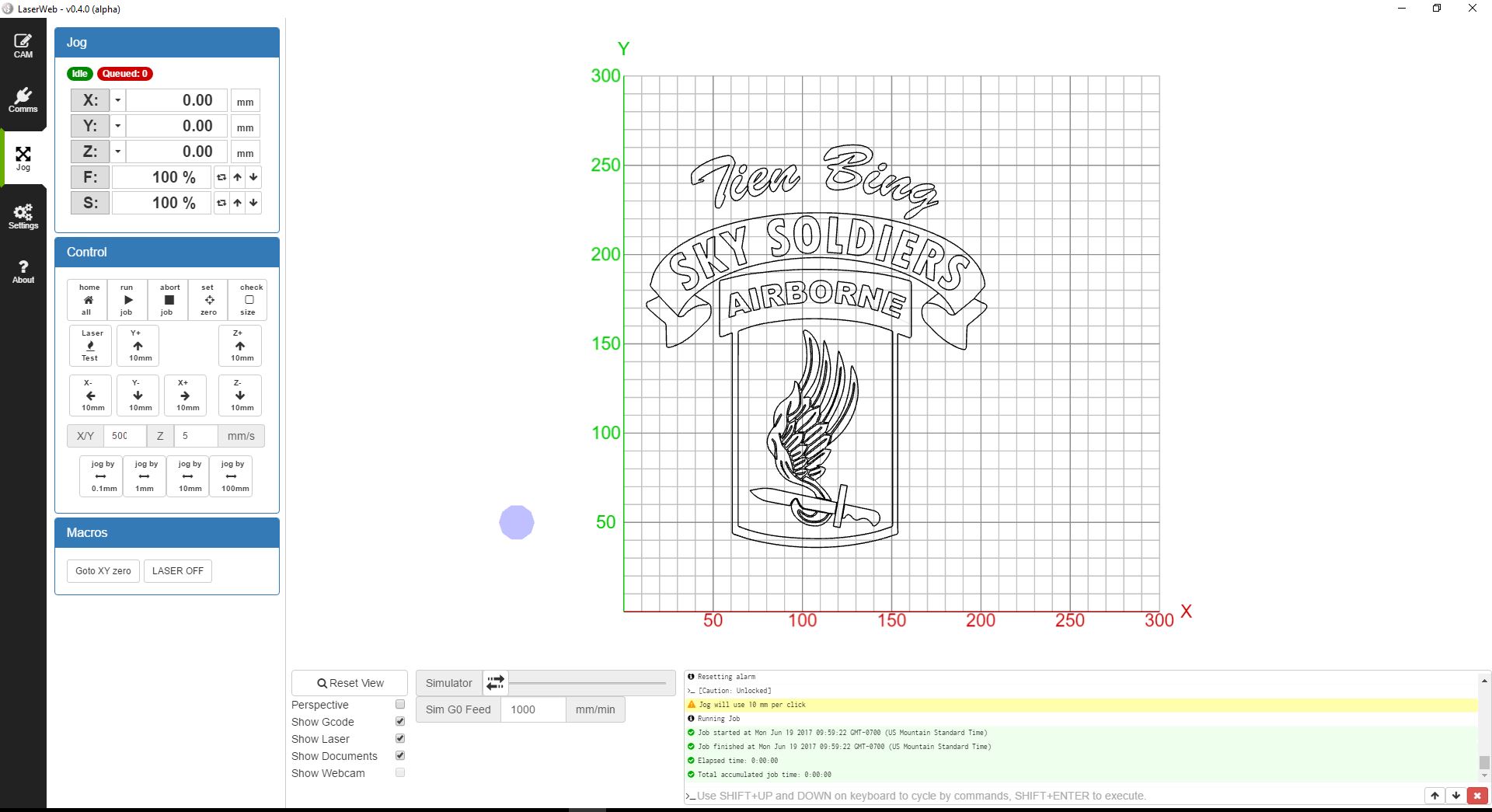

I load an svg file into LW4. The image comes up on the screen, I hit run and the progress screen shows job started and finished without the job actually running. When I start the machine I get,
Machine connected
Firmware smoothie edge-7d257e9 detected
but nothing happens.
When I hit jog the x and y numbers change but the laser doesn’t move.
I have the machine profile set for Generic smoothie machine. What am I missing?

@bbowley2 it’s imperative to know if you went into the comms tab first and selected the port and then pressed connect
Also a screenshot of the files screen just after generating the gcode would be good

@bbowley2 please provide us the following:
- Screenshot of your LW4 at the ‘files’ screen (Full app screenshot, so we can also see the messages log) right after you’ve completed gcode generation… (As @Ariel_Yahni_UniKpty asked)
- config file from your smoothieboard (it’s on the SD card, which should be available as an external drive on your PC. (So we can check that the smoothie is configured correctly)
- The LW4 version number (on About screen and probably also in your titlebar)
- Whether you are using the LW4 app standalone, or through Chrome browser, accessing the system via it’s web server component

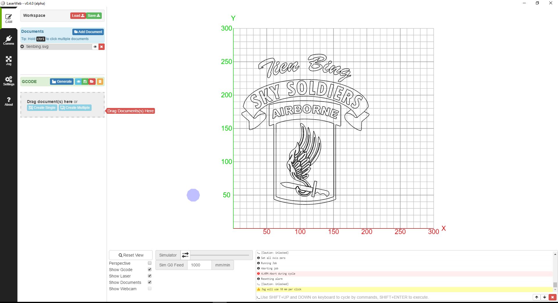

I’ve not been able to generate a gcode.
Without gcode nothing will ever happen… Then just screenshot it after you’ve pressed the generate button, even if no code comes out, so we can see what’s there! And don’t forget the other stuff…
You need to download the newer version. This one is to old, download here https://github.com/LaserWeb/LaserWeb4-Binaries/releases
