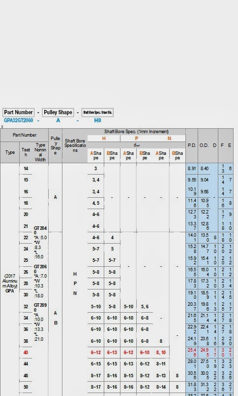

I located a gt2 pulley for 10mm shaft. our friends at misumi have it.
I located a gt2 pulley for 10mm shaft. our friends at misumi have it. it has 40 teeth and is the red highlight row below
too bad they cost $20 each
