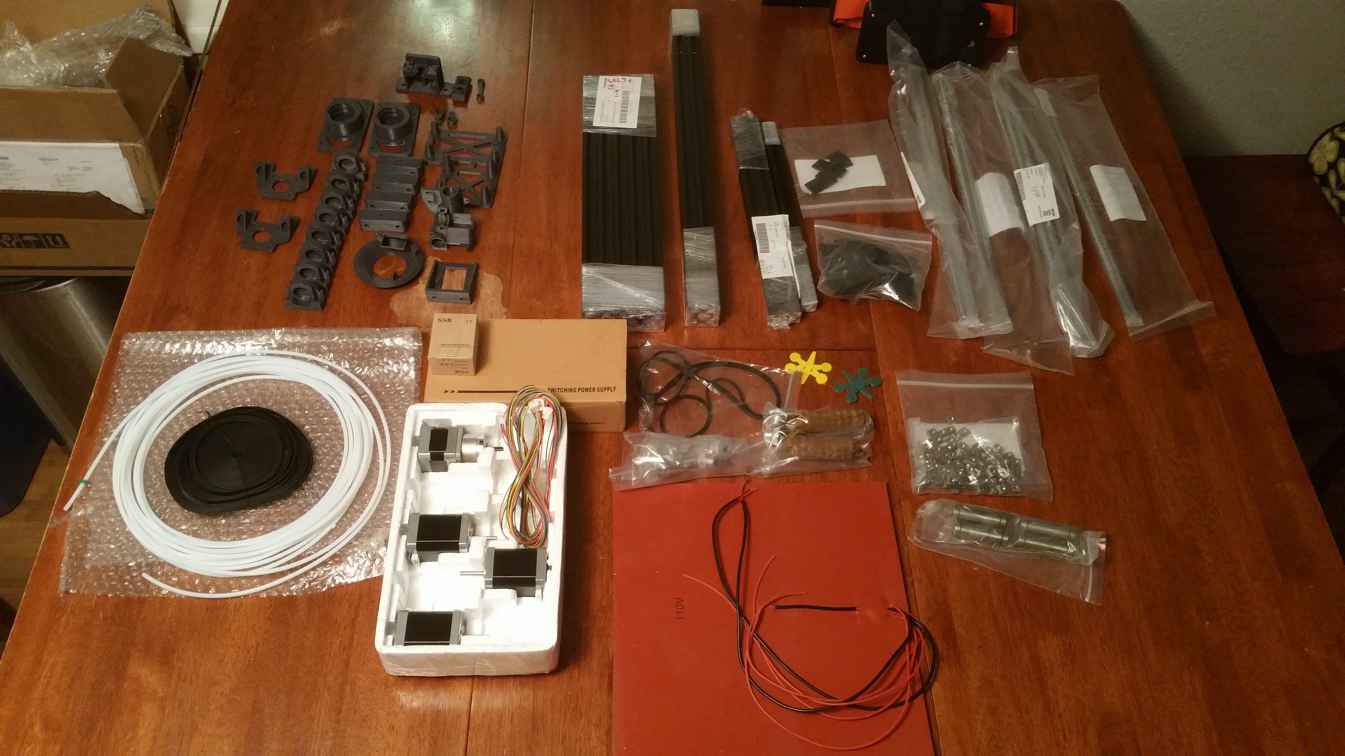

I love it when parts start rolling in!
Welcome to the club @Kevin_Conner ​. Glad to see another Eustathios preparing to take shape. There are so many knowledgeable makers here in our group. Please ask as many questions as you need throughout the build. The more build posts we get in the group feed the more information is available for others as they start their builds.
Thanks. This will be my second scratch build. I’m really excited to make a gantry printer.
