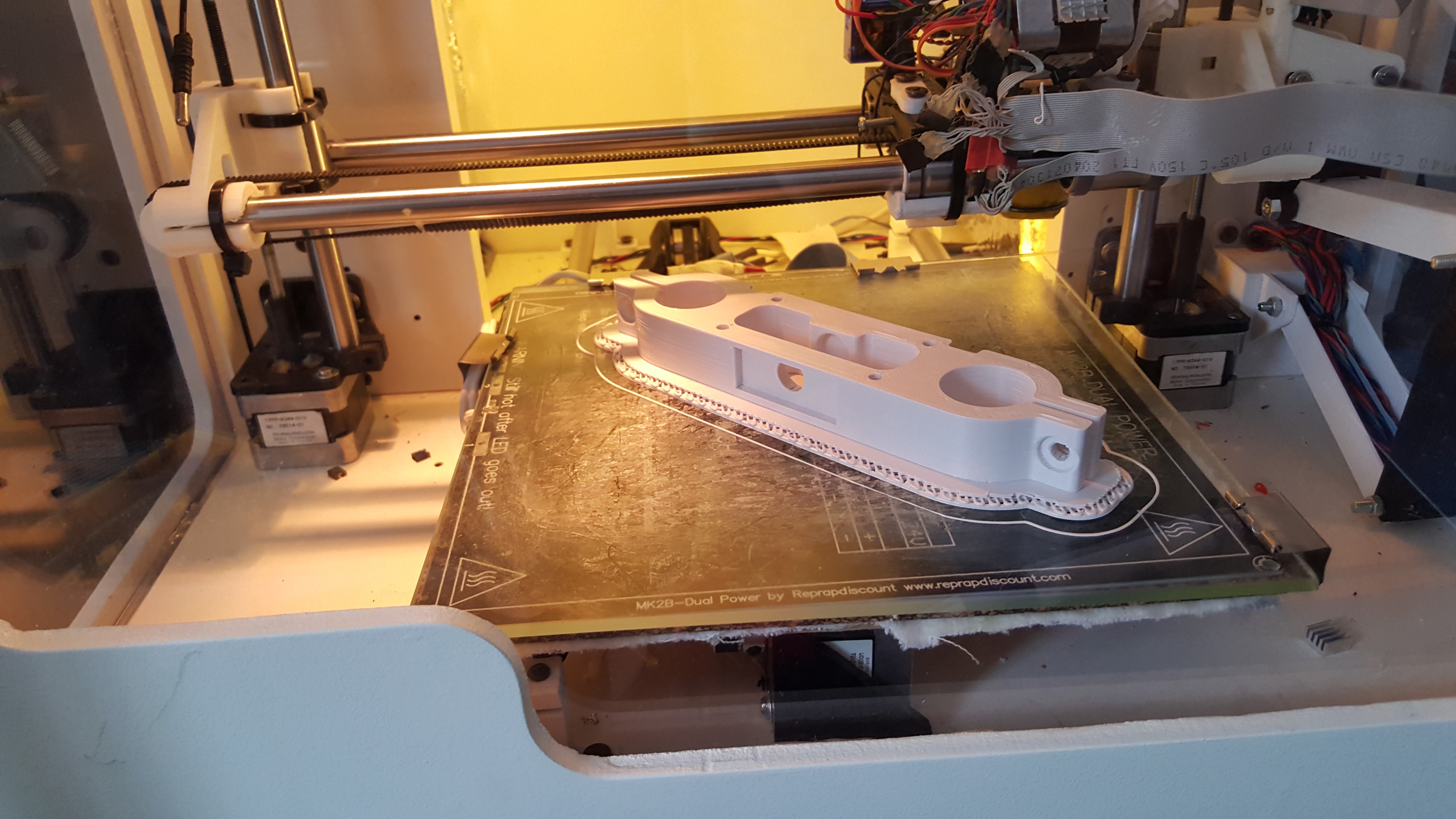

I love my heated chamber :-) abs print on to Glass with gluestick.
I love my heated chamber :slight_smile: abs print on to Glass with gluestick. 0% warping
Nice. What’s the:
Printer?
Slicer?
Head & bed temps?
The printer is a modified mendel 90.
Slicer is simplify 3d.
Heat bed at 110c (about 90 measured with ir) e3d v6 at 250c (I know this is hi but i normaly print at 245c, my temp probe is probably off some…) .
Chamber at 38C

What do you use to heat the chamber? Can You share more pictures of the chamber? I have a Mendel 90, and would be interested and n learning more about what you have done
