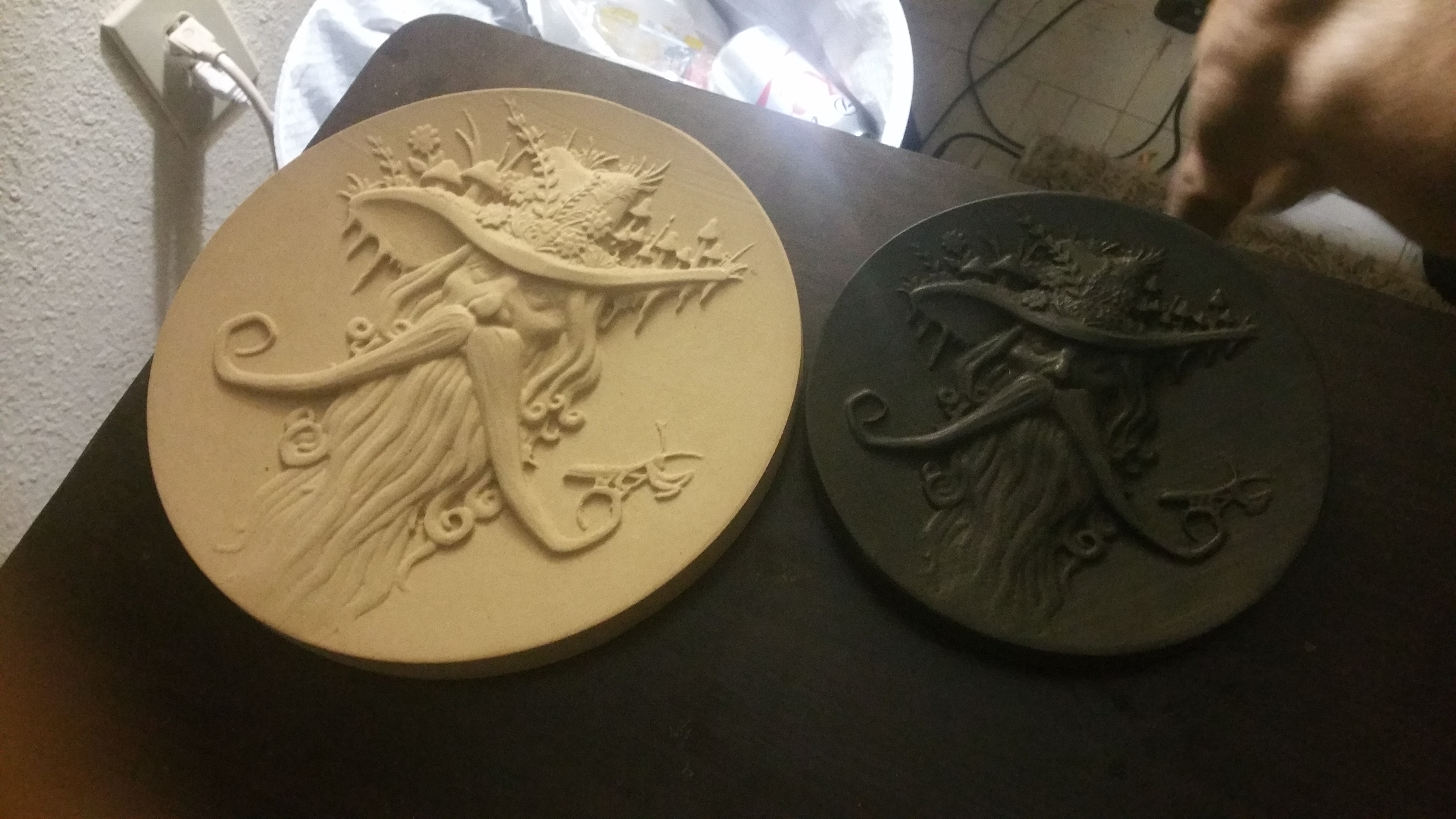

I love my new R7. Here are my first two cuts.
I love my new R7. Here are my first two cuts. There were a few tuning issues to start with but the first two cuts were two sizes of the same model. Yes it does do relief carvings.

Those look amazing. Are those your designs?
No, I downloaded a free 3d wizard model and used Vectric Aspire to create the dished model you see here.
Nice. Looks very smooth, what was your stepover and bit size for this?
.125 ball mill 10% stepover on finish pass

@BuddahrobSidartha_Ro Is the stock modle R7 with tiny g able to carve this with the aspire or did you have to get something else?
Yes It carved it with tinyg, using Chillipeppr. Aspire created the toolpath to put into chillipeppr.
