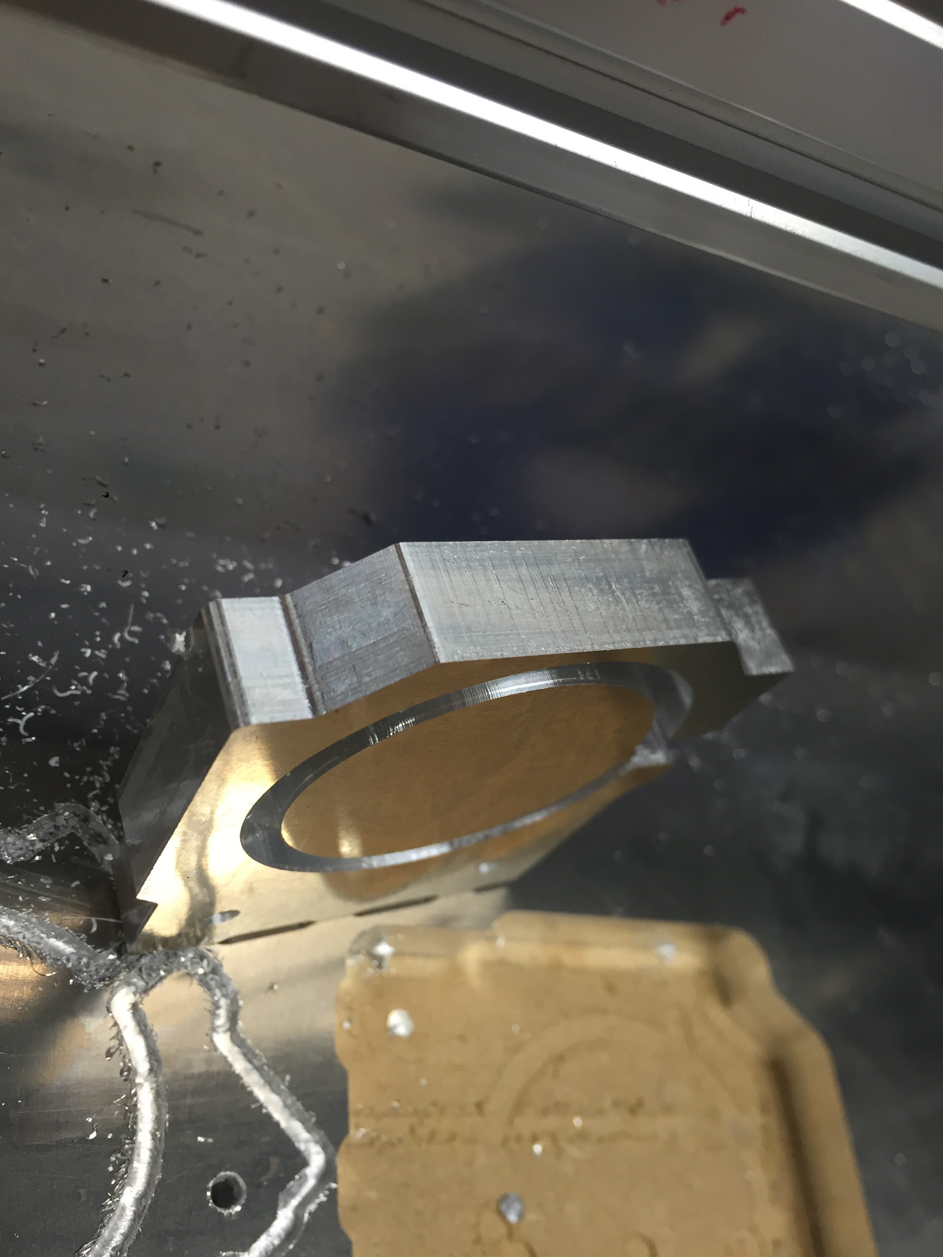

Yesterday I was cutting a clamp, and doing multiple to check repeatability. I had 2 failures, haven’t had one in a long time but both led to a busted endmill.
In the upper right hand side of the inner circle I would get chatter and the endmill would snap and ruin the work piece, as seen below. I tried slowing down, heavier load on the endmill, lighter load, nothing seemed to resolve this issue in this one spot.
I played around a bit more and sat and watched a full cut. The depth didn’t seem to matter, but it did get worse the deeper I went around the entire work piece.
Looking into it, it wasn’t the first pass. The first pass is at 3.65mm width and .6 deep at 600mm/m, the total cut width (to give the chips somewhere to go) 4.05, so a .4 step over second pass. I like cutting like this as it leaves a finishing pass look on the final work piece without having to run a finishing pass. This was the issue.
I never had chatter on the full endmill load. The .4mm step over is where the chatter is. I was only using ~ 10% of total cut width. The load is not sufficient for the speed I was traveling.
I adjusted to a .6 step over and all is resolved. The odd thing to me is I cut .25" thick plate with .4 step overs all day, the .5" thick material is the issue. It seems it would be machining the same step regardless of depth?

By taking so shallow of a cut in aluminum, perhaps you were riding up on the edge instead of cutting and “bending” the endmill (to fracture). Is the problem area doing a climbing cut?

@Jerry_Fountain no this was conventional. I do believe it was simply too small a cut and side loaded the endmill. Issue has since been resolved with the heavier step over.
