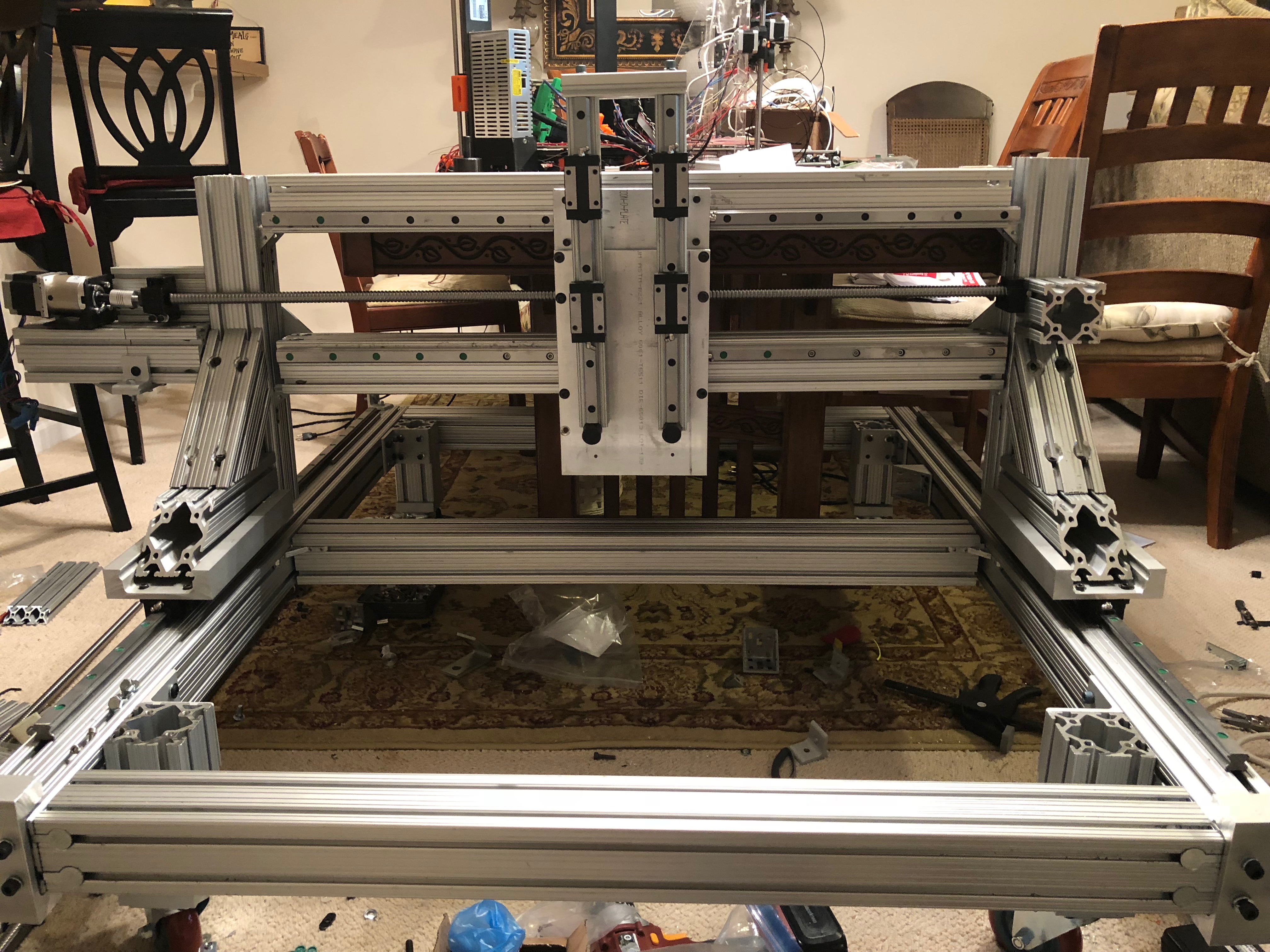

I’m glad y’all noticed that about the work area. You were right.
I’m glad y’all noticed that about the work area. You were right. I just moved the rails up on the plate. I’m going to cut the bottom part of the plate off and that will give me a total of 7” of work room, before the spoil board.
Seven inches is a generous amount of work envelope in the Z axis. That should suffice for just about anything you are apt to do.
@Paul_Frederick Yes, I’m happy with that.
You should move your x rails to the outside, slot further apart the better.
@Paul_Shaw Yes, they were initially on the top and bottom ones, but the plates are already cut, so that would have to be changed at a later time. Another issue was the length of my X beams. But, I’ve got to conserve some $$. Recutting plates won’t be done until I can do it with a CNC.
