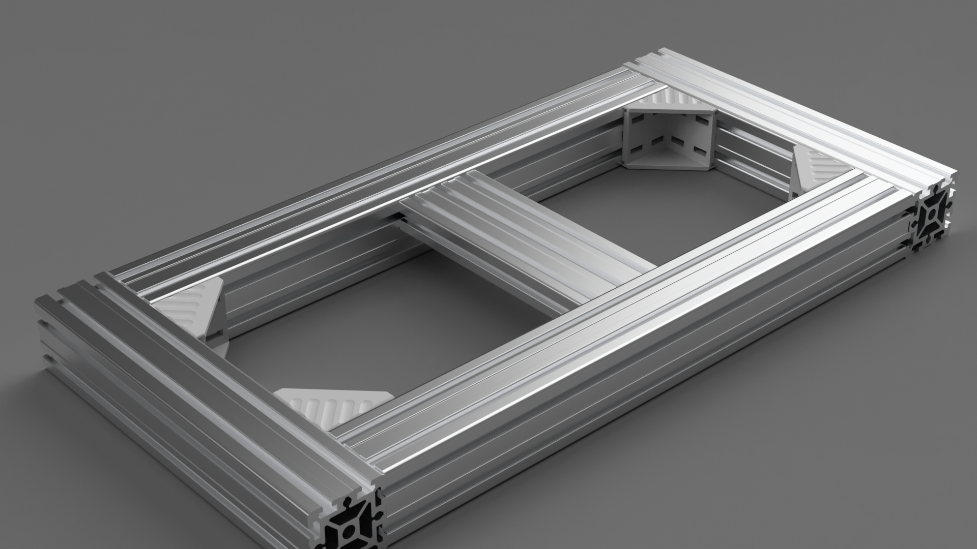

I`m going to get some Bosh 90x90 alu profiles,
Im going to get some Bosh 90x90 alu profiles, so Im going to use them for the main frame. Solid/stable frame I think :slight_smile:
it seems to work for them https://www.cnc-step.de/

This is my first CNC build, and I do not have the tools to work with steel. Using profiles like this I`m able to build an ok CNC using the tools I have + I did get a great deal when purchasing the profiles…

I guess I`m going to alter the design some times before I start the real work. I get new comments… all the time about things I should alter… It is great that I can use software like Fusion 360 to test ideas and do corrections until I have the design I want to use.
