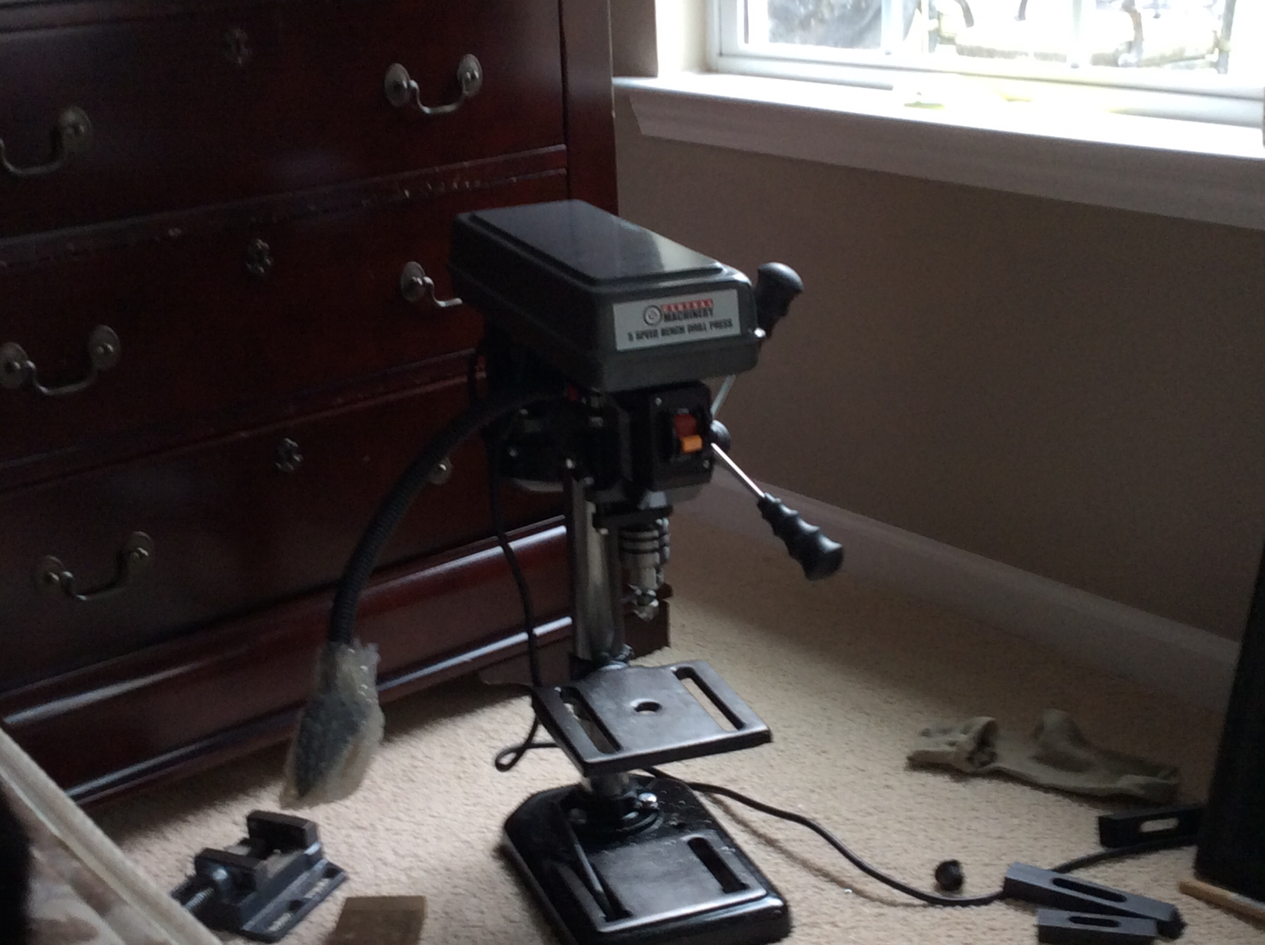

I’m in limbo for a few days until I get the right drill bit. Meanwhile, I bought a benchtop drill press from harbor freight…not too bad for the price $67.
It beats using a pistol drill. On some of the really cheap drill presses the table flexes when you push down on them so consider putting a piece of wood under it or something to beef it up some. But even at its worst I bet it’ll drill a lot more square than folks can by hand. This is my drill press http://i.imgur.com/jXSFT.jpg She’ll poke a hole in solid steel a couple inches in diameter. I bought it off Harbor Freight too.
