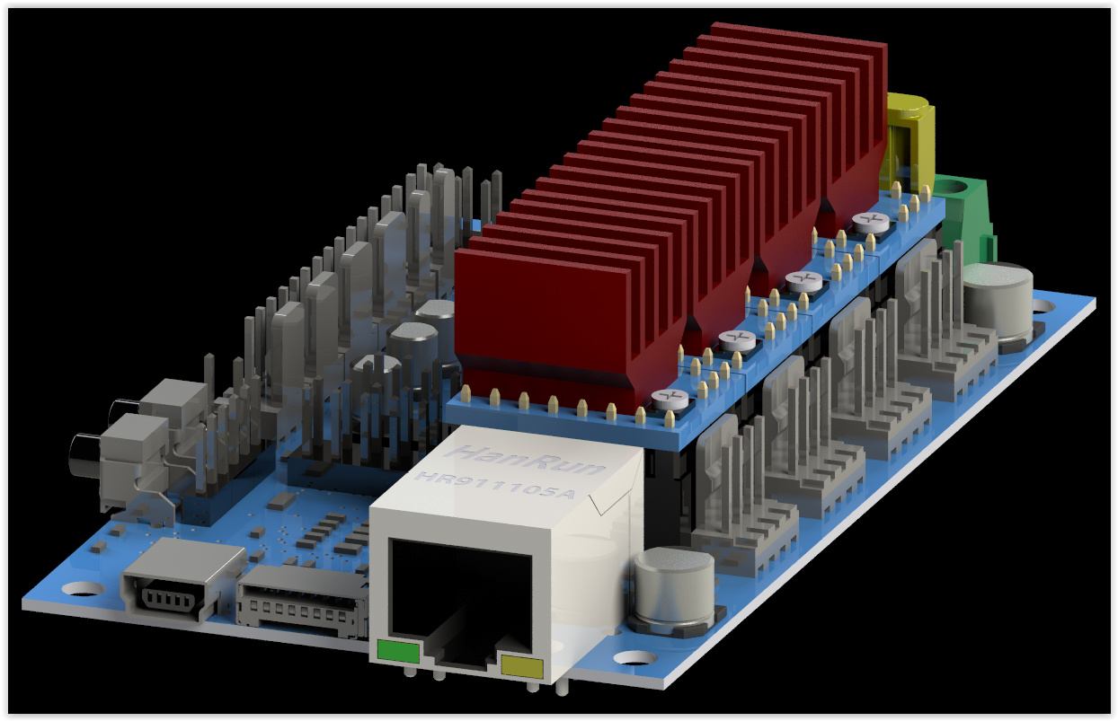

I made a model for the Azteeg X5 Mini V3 (with a great starting
I made a model for the Azteeg X5 Mini V3 (with a great starting model provided by @Roy_Cortes ). I did it so I could update the mount for the Eustathios Spider V2. I made a new electronics mount in two configurations (side by side and over under) along with the raspberry Pi for octoprint.
Let me know which one looks best and I will modify the side panel to line up with the new mount and ports.
I added the controller model in several formats, as well as STLs, and Solidworks files for the mounts. It was a part of the latest commit on Github.
@Alex_Skoruppa ​ 70.68mm : https://photos.google.com/share/AF1QipMlKEgVvHboMGLAcO4-zBU-c1h_NnZMXbQevVxDV8yVmBQgodcGxsJyfvWZ_pI2RQ?key=ZTg0MzhVNWgyQmFpUXBlRDhkSXZuZjZreWxkNFN3, the spacer between the boards is just over 20mm.

I’m still liking the side by side variety. Is there a simplification reason why stacking them would be easier/faster/better? There isn’t a shield type connection, is there? I just like the wider/thinner layout as i’d have access to everything, it’s not like it’s tight for space under there! :slight_smile:
@jerryflyguy ​ there is no shield, I just figured it might help keep things more compact and allow cabling to be kept neat. Also it might be helpful for people who plan to use this setup in another printer without such excess of space.
@Eclsnowman yeah for sure it’s more compact. No doubt it’s simply preference on either the HercuLien or Eustathios
