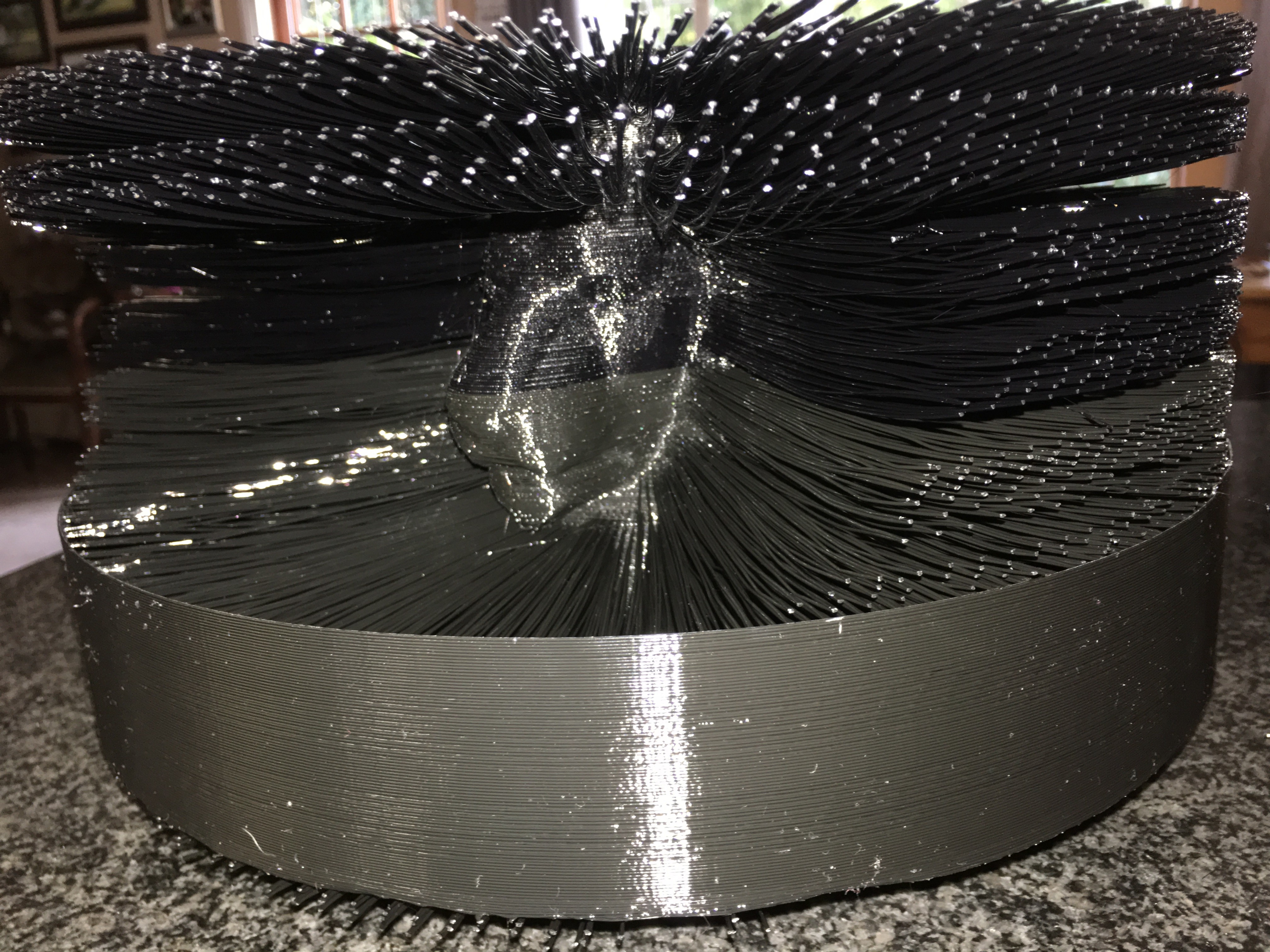

It’s the big hairy lion printed at the size in the file. I could scale it bigger on the machine but it’s plenty big enough. Used 3 rolls of filament. Cura initially estimated 4,6kg. I reduced it by lowering the infill for the lower 120mm of the body to 10% and a single shell. That was printed on a machine with a 0.4mm nozzle the upper body was printed with a 0.8mm nozzle.
The downside of the larger nozzle apart from loss of resolution is that you need to print slower to keep the filament flowing smoothly. The machine doesnt have a volcano nozzle just a larger dual heater block. But it probably needs to have a larger melt zone to go faster.

I didn’t want to risk the extruder not being able to pull the roll. I even tried finding the same batch black but it was all finished. The colour change is from the same manufacturer and supplier but a different batch. You can hardly notice looking at it but a picture with flash it’s very clear.
Yeah i see it
