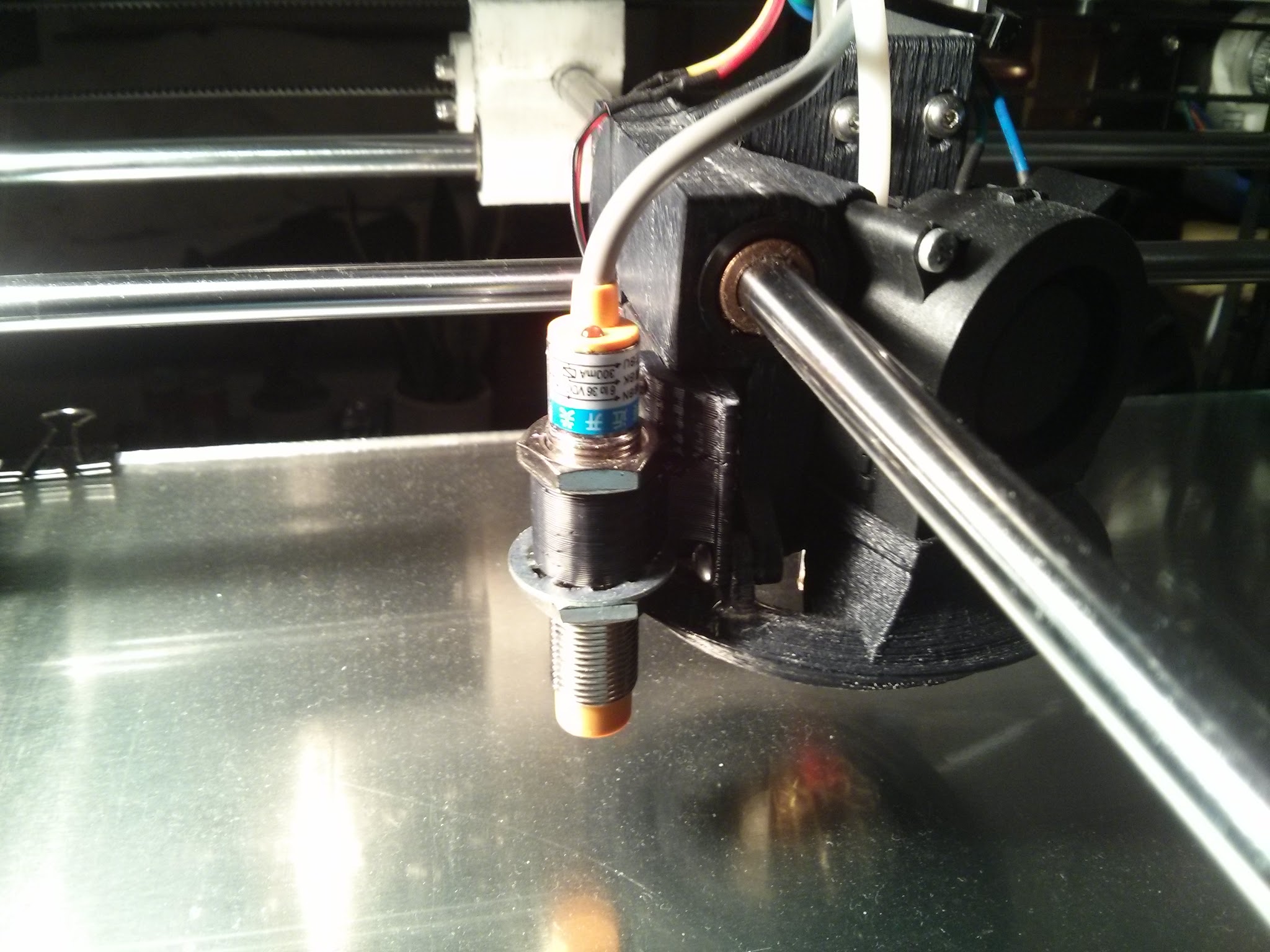

I made an inductive endstop mount for z-axis. May also be used for auto bed leveling. It is mounted with existing screws . One on cooling duct mount and one on hotend fan mount. I tried a few versions, but this place for mountig is the one where i lost minimal build volume. Only 3-4mm on y axis. When @Eclsnowman has set up his github for modified parts, i will upload there.

To be honest, I didn’t really tried to use it until now. I have to remove my glass plate to detect the bed (detection distance ~2-3mm, but 4mm glass). The problem is, that i can’t bring the bed up anymore because i use old bed supports with new carriage. But new parts are on their way.
@Jean-Francois_Coutur It’s a standard sensor called LJ12A3-4-Z/BY. You can find these for a few bucks on ebay or amazon. They have 12mm OD and a detection distance of 4mm. But it does not react that much on aluminium, so you end up at ~2-3mm. There is also an other sensor with 8mm detection distace, but it has 18mm OD (LJ18A3-8…). So you will lose some millimeters more in build volume.
I found that the ebay sensors will only detect 1mm away from my aluminum sheet- so it won’t work even with 1/16" glass. Some people add a thin galvanized steel sheet on top of the aluminum which has more inductance - I haven’t tried that yet.
As i say. My Sensor works at 2-3mm. Maybe i will try the 8mm version when i habe time for that.
maybe there are differences between ebay sensors. This is the one I got: http://www.ebay.com/itm/221457637744?_trksid=p2057872.m2749.l2649&ssPageName=STRK%3AMEBIDX%3AIT - the only difference in the number is /BX (LJ12A3-4-Z/BX ) which is an NPN. Maybe the PNP version is able to work for 2-3mm while the NPN only 1mm.
I got this one: http://www.ebay.de/itm/New-LJ12A3-4-Z-BY-Inductive-Proximity-Sensor-Detection-Switch-PNP-DC6-36V-/351323770970?hash=item51cc87505a:g:MX4AAOSwfcVUBFG-
Manufacturer is called “SHNRQ”. Maybe tere are differences between manufactueres. As far as i understand electronics, the difference between NPN and PNP is that PNP is normally open (NO) and NPN is normally closed (NC).
Maybe voltage makes a difference- I am only using 12v?
