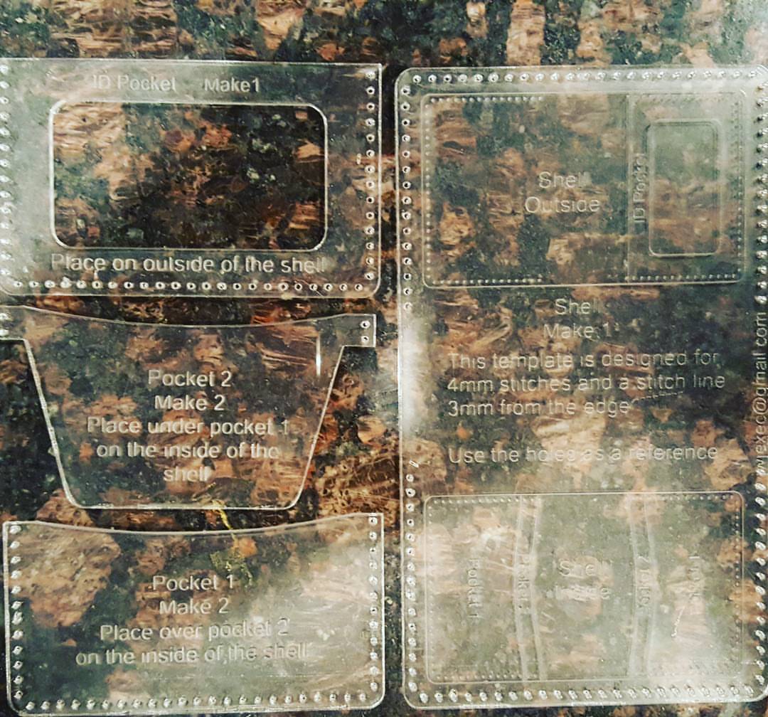

I made my first real item this weekend. I earn a little extra toy and vacation money with leather work. Wallets are the most common things I make and I’ve been wanting to replace some paper templates with acrylic. After hours of testing I came up with this - it’s one of my more popular designs. I’ve had several requests over the years for templates so I suppose I’ll be selling these as well once I perfect them.
for the text and instruction images, I converted the vector to bitmap and then back to line drawing for a nice low res single line vector. I cut it fast, 25mm per second at about 2.5ma and it makes a nice engraving without having to wait 10 minutes or more for an actual engraving.

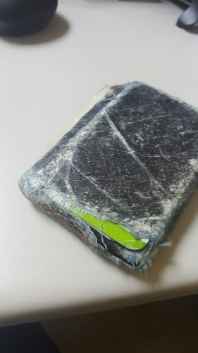

I am addicted to wallets, the latest I bought is made of tyvek and it’s just about to die. I would love to make my own ones.
They’re fun to make, for me anyway. I started by taking apart some cheap wallets and seeing how they’re made. Then I discovered all the wonderful videos on YouTube.
So you use those templates to mark on top of leather and the cut it manually?
yes, I mark the back side of the leather and then cut with a razor. I use a steel ruler to make sure I cut straight lines. If you’re careful you can use the template to brace the razor but you have to make sure you don’t cut into it.A really sharp razor is important. I use a new blade every couple wallets.
