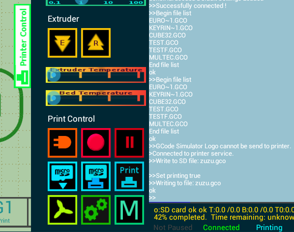

I made some progress with SD Card support.
-Two new buttons SDUpload & SDPrint added
-List files on SD card and choose one from printing
-Upload current gcode to SD card and start printing
Only progress reporting during SD print is missing. (M27)
