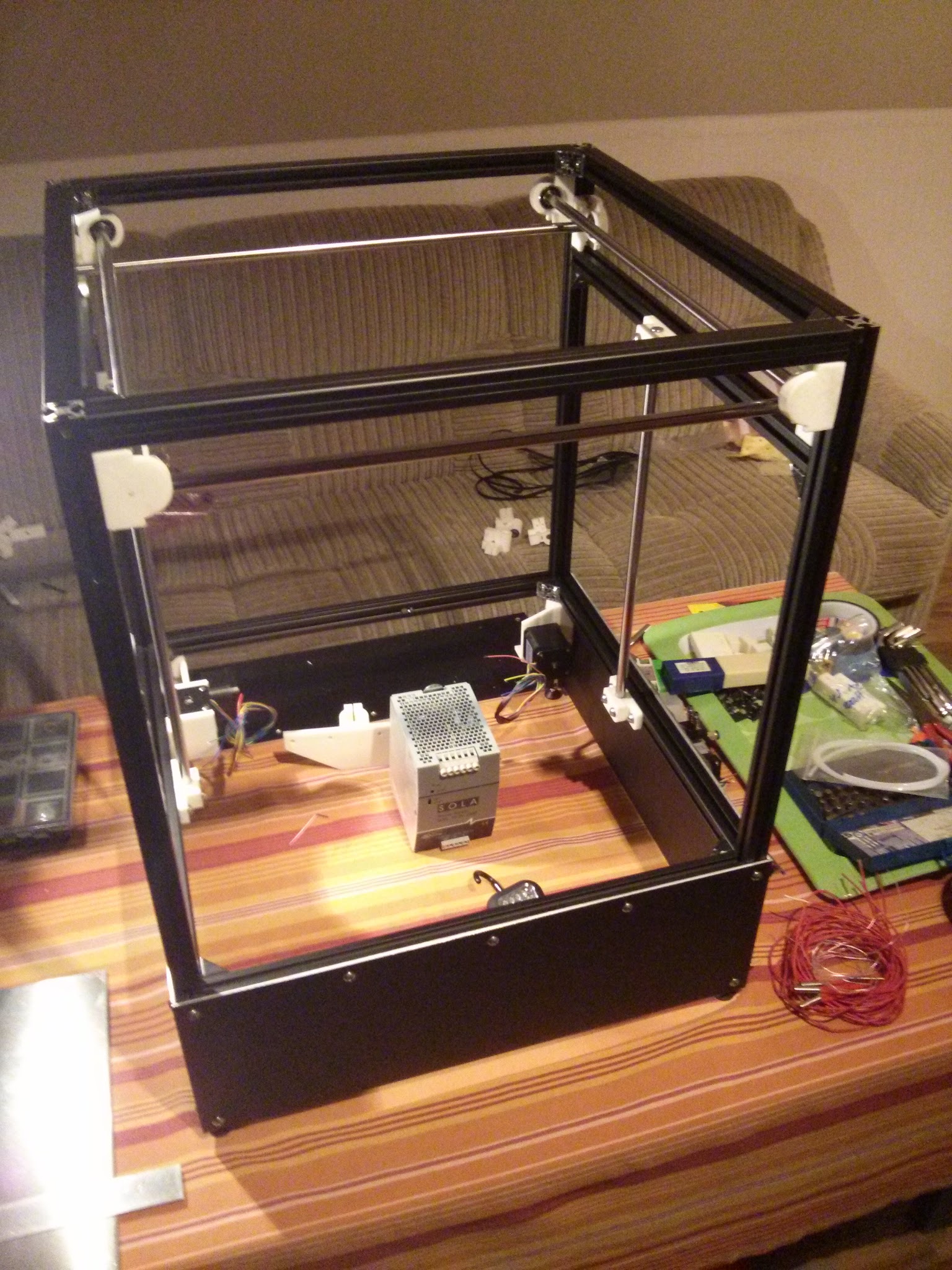

I made the expensive pulleys from #misumi by doing some rework of cheap 32T/10mm pulleys from #robotdigg . I milled off the collar and drilled M3 threads between the teeth.
I hope it will work like expected. But some parts didn’t made their way to my postbox before christmas. So it may take some time to test the pulleys.
