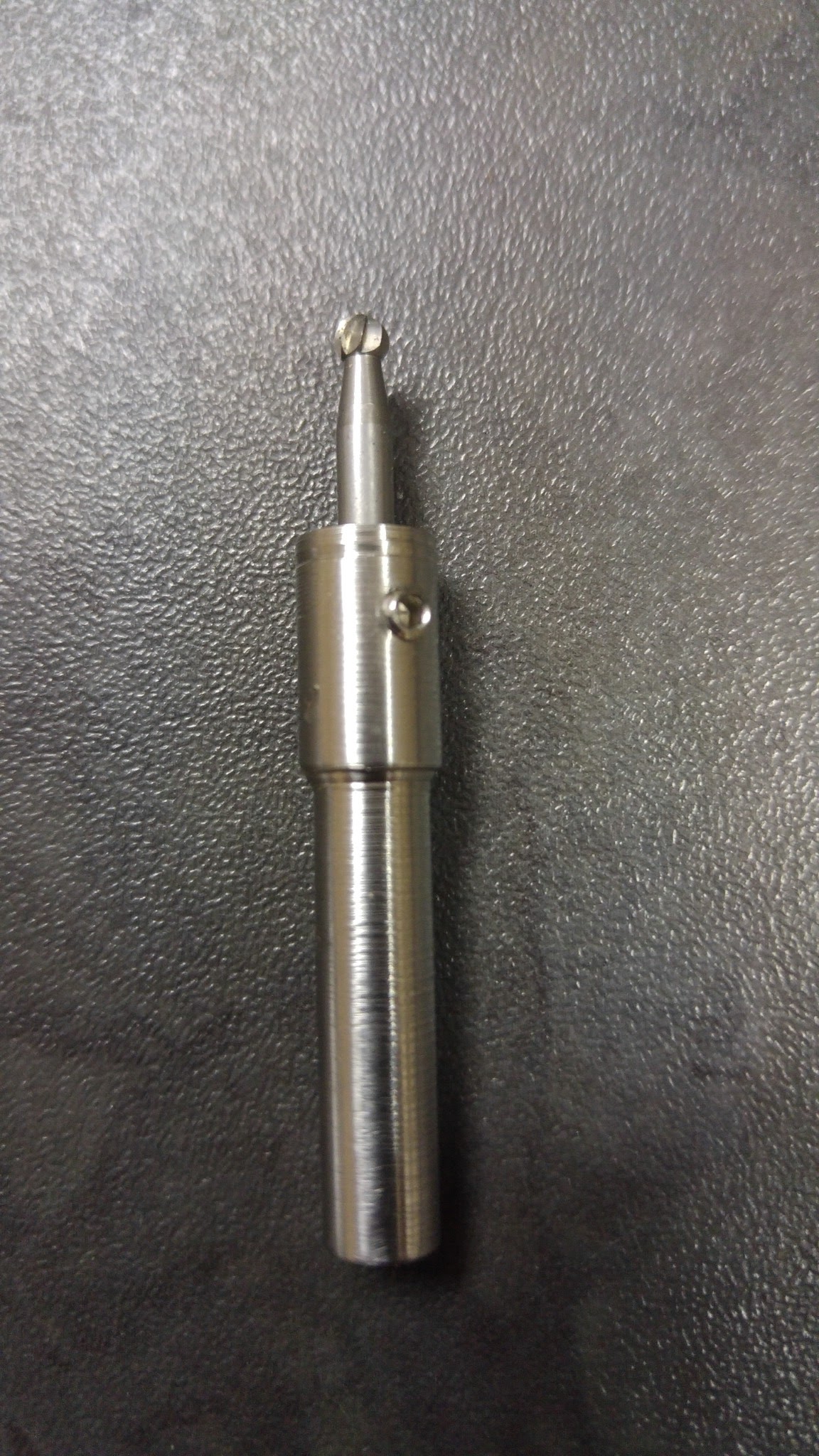

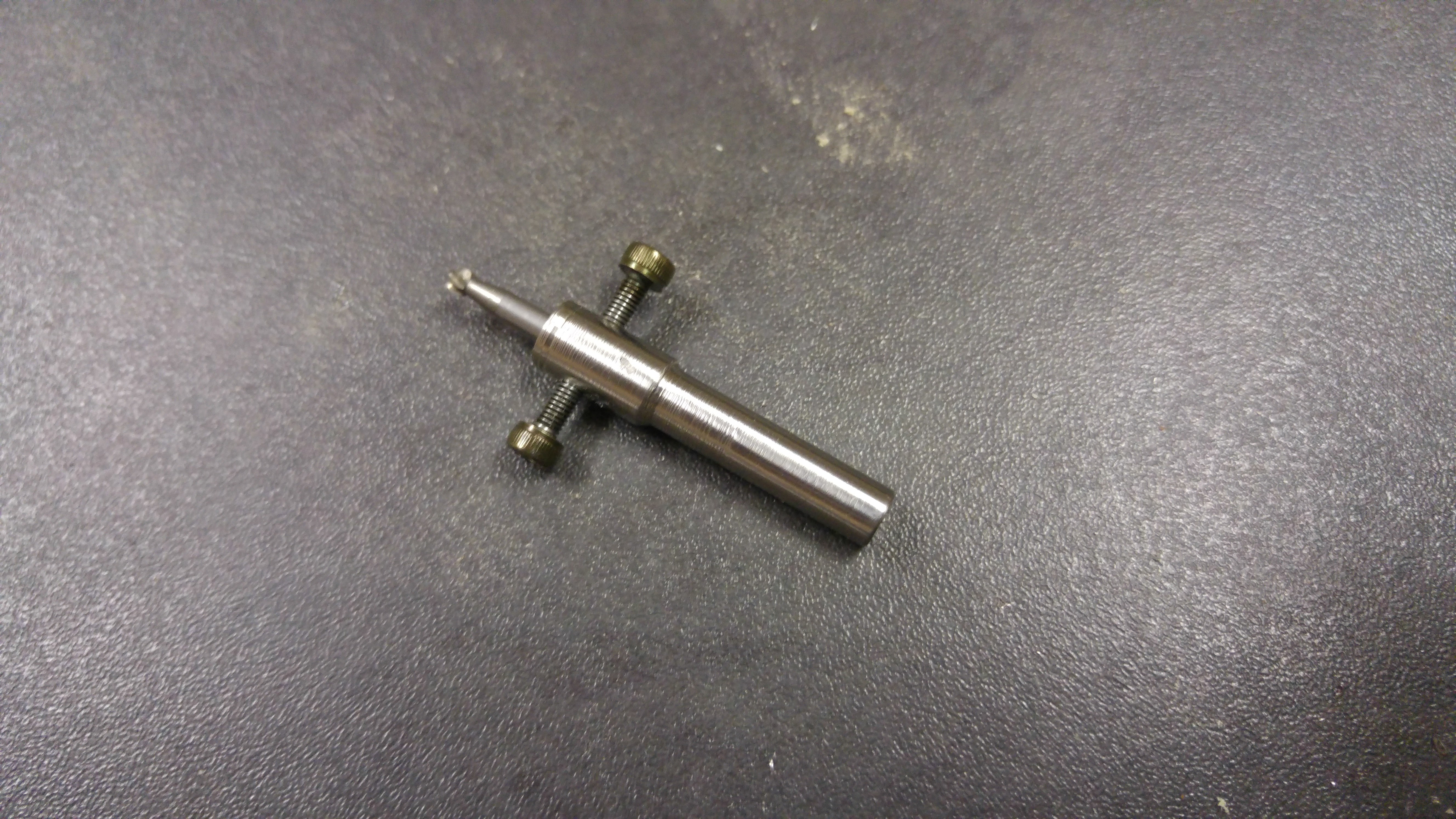

I made this. I’ve been waiting for the guy I got much of the parts from to open so I can get a reduction collet for dremel bits. Then it occurred to me I have a lathe and made this in stainless steel. Used two screws to balance it. But I’d like some feedback. Those little suckers coming out at 10000+ rpm is not exactly something I want to be around for. Thoughts?
Rather than add mass, try removing mass.
Or maybe I could supply a useful comment instead of some stupid reply.
Dremel does sell a collet system. Any chance you could make that work for you?
use set screws
@Paul_Frederick much cheaper than buying something only to reverse engineer it.
I made similar tool utilising the dremell/proxxon collet system. I drilled the hole for the collets and threaded the outside for the collet nut.
They do clamp down the bits. I can cut them down on the lathe to be more stubby. I was thinking of using internal screws like the pulleys have but making it more complicated than just buying the collet is pointless right?
It was just the 1st dremel tool in the box that didn’t look like it had been savaged.
Yup I got a couple of those the other day.

What I did realise about this tool is that I can take smaller drill bits e.g. 4mm turn down the back of the shank on the lathe and use this tool as an adapter for smaller bits.
