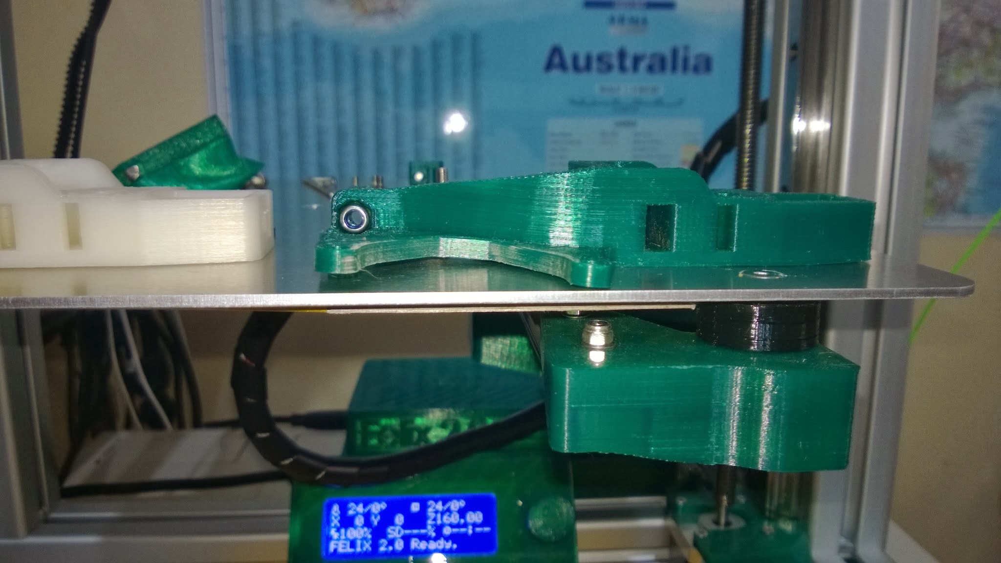

Just tried 100 degree bed with glue and a 4mm brim. BUT it has bent the print head again. Only slightly, but the air duct hung too low (different to the picture above).
In a bit of a catch 22. I need an ABS print head, but can’t print one out of ABS because it melts the print head.
Is there anyone out there that can print me one? Happy to cover any costs. :slight_smile:
@Ben_Jackson Are you talking about the interface between your hot end (j-head or whatever) and the extruder carriage (cold end) getting so hot the PLA extruder softens and the hot end becomes loose? If so, you need to point a fan at the top of you hot end to keep it cool during the print.
Hi @Tim_Rastall Yes it is the part pictured above. It (along with other parts, but this is the main part) holds the hot end on the X axis. It already has a fan and I have increased it from the default 5V to 12V for extra cooling. However the fan doesn’t really cool the bottom properly only the top. IT does seem to cool the top effectively.
With high hot end temps (230 degrees) the weight of the extruder motor is pushing this part down and bending it. Apparently if you can get one out of ABS everything works out OK. I have the STL for it.

Ah, right. It’s the PLA of the print head that I’m worried about. The peek does some insulation, but obviously not enough. I am designing and printing a modified air duct that will bleed off some air to cool the bottom of the print head.
