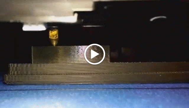

I modify my smart extruder and now working without any problems.
I modify my smart extruder and now working without any problems. No more clogging and clicking sounds.

M6 threaded rod I reworked by drilling. I removed the Teflon tube and replace it with a new one that goes through the entire threaded rod. Only 2 mm threaded rod without Teflon tube. The temperature of the extruder is now 200 C. I only use Simplify 3D slicer program.
