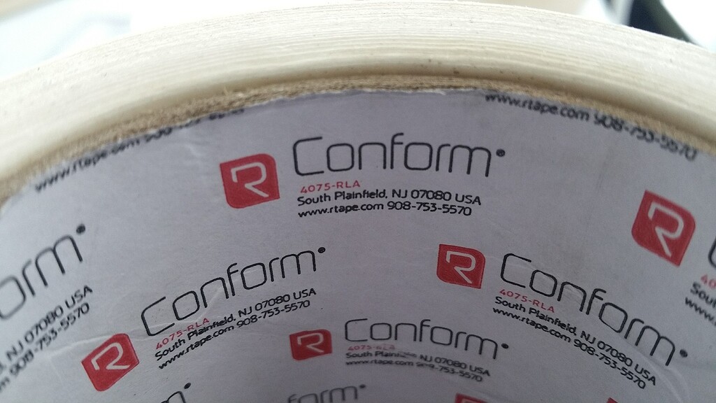

The only way to avoid scorching is to use masking. I use this stuff in 8.5" wide rolls.

@donkjr and @NedMan Thank you for the info! I have a couple of rolls of transfer tape. It doesn’t seem to adhere well in the very cold temps of my garage (48ºF right now). I found that it lifts off the surface and then smoke/particulate gets trapped and it adheres. That being said, I will try it with a higher power and see.

Transfer tape comes in different levels of tack. The one I link to above has very good tack, but I can’t attest to how it performs in colder conditions. That Transfer tape was recommended by a member (@ashley_M_Kirchner_No) from the G+ days that worked in a sign shop and tried a bunch of different ones.
I almost never have problems with the tape lifting off during use. If you are sanding the wood first, make sure to use a brush to remove all the dust as that can cause problems with adhesion. I also use an ink brayer roller to make sure the tape is adhered well.
I use this 4" soft rubber one with a firm rolling pressure. They come in different widths.
