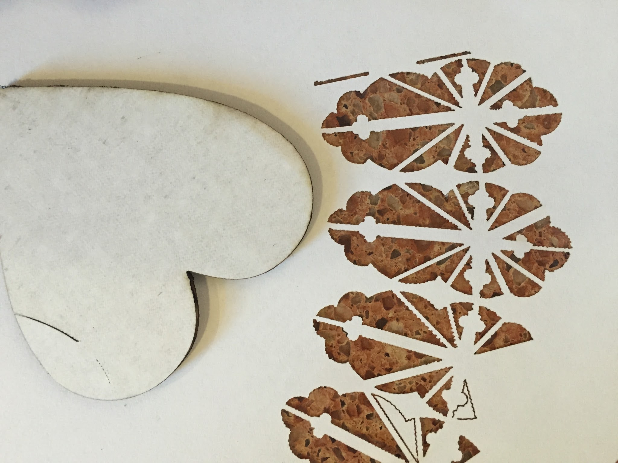

I must be doing something wrong? Having had the laser less than 24 hours, this is probably the case. I was able to successfully cut paper using an svg from http://monicascreativeroom.se/category/cutting-files/cupcake-wrappers. That file, however appears jagged, I was expecting something more smooth.
I was able to successfully cut through cardboard, but it took about 7 passes. I was expecting to be able to easily cut through cardboard. Granted, I haven’t yet installed an air assist, but I assumed slightly better.
I was engraving and atempting to cut some old MDF laminate flooring. Learning how to recenter the laser each pass. I was expecting to be able to cut through this as well. How many passes is “normal” to cut through various materials. I’ve read three, so maybe a setting is wrong?

Looks like your are trying to cut to fast… the jagged edges of your cuts on paper

I was cutting at 7mm/sec I’m going to try an alignment soon.
7mm sec is way to slow for paper - you might be burning the edges.

Those jagged edges almost look like a small bmp file being enlarged too mnuch and losing resolution.
