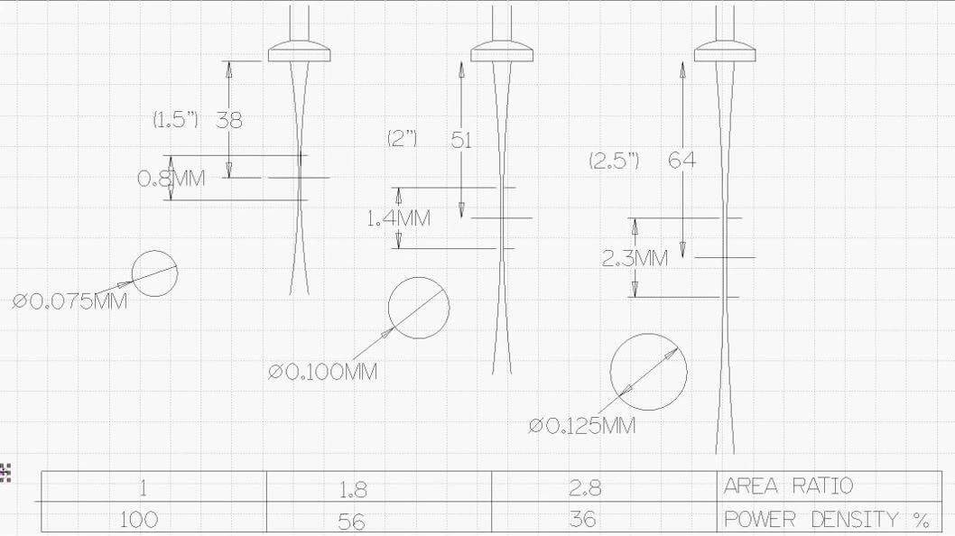

@donkjr ​ does this help you visualize it?
That’s what I thought. You loose power because the energy density is lower do to larger spot size but the DOF is longer.
