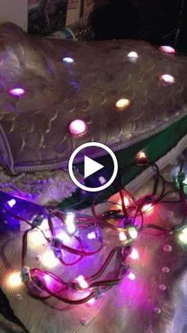

I need a little more mermaid tail help. I have hooked up some WS2801 LEDs alongside my neopixels. When I call both types of chip at the same time I get a very strange intermittent flicker in the neopixels, while the WS2801 LEDs work just fine. If I comment out the line calling the WS2801 chips, my neopixels work fine (but of course not the WS2801 lights). Any reason why this might be?
