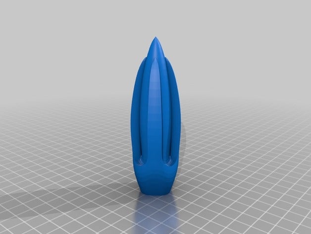

It went far easier than I expected, and very quickly. The smaller inside portion has a concave underside, with zero flat surfaces. It would be necessary to add a raft and/or supports.
My slicer (Simplify3D) tells me more than 12 hours to print both pieces.
The concavity bothered me. I’ve jumped back into the project and performed a plane cut. Now the part can be printed flat, no raft, no supports.

ok i downloaded both files, and oh snap now for the big question, will the little piece go inside once printed, i better but some white PETG for the added flexibility lol
@Cristian_Martinez No, it doesn’t look like it will fit. There are three pairs of “fingers” on the top of the big part, and four fingers on the small part and no rotation will allow clearance.
If your printer is too small to print the large piece intact, cutting it in two horizontally with Meshmixer at a suitable location for printing will also give you the ability to place the inner part before re-attaching.
