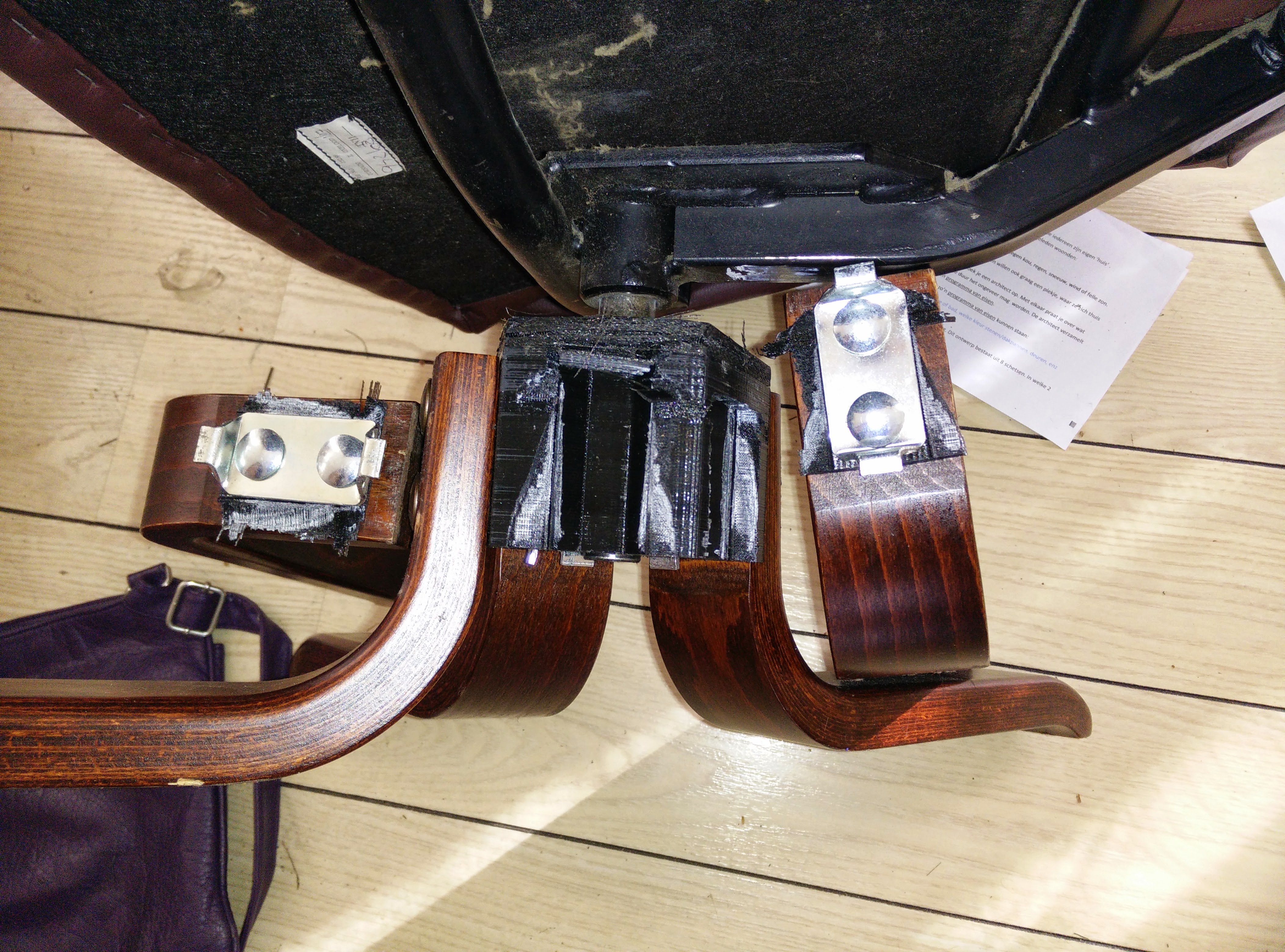

I need material advice. I printed a broken part of a chair.
I printed a broken part of a chair. With Black PLA I know it won’t hold up to the forces. But It worked for 5 weeks.
Now I want to print it in a stronger material.
I have a Ultimaker original with headed bed and dual extrusion.
This mean my hot-end has a teflon tube. so I can’t print with extreem hi temps.
I was thinking of printing with nylon but what is the best type of nylon or are there better options?

It was perfect en strong, but just not strong enough to use the chair for more than 5 weeks.
So I need a better material. At this moment i only have printed in PLA so its time to try something better.
Now I want to use the experience from the people in this community to find the best material for this job.
You can also think outside the box. You presumably recreated the original part design. Nothing stops you from changing the design to make it stronger and more suited to what you need.

I already made al the walls triple the size. And i don’t know how to make it stronger.

Also, PLA is brittle. You want something like ABS or or nylon, which is tough.
Nylon will hold a good deal more than pla or abs, but it is always slightly elastic and might be distorted to the point of uselesness. Creating a mold and casting the piece in aluminium is very much the best solution. I dont think resin or epoxy will help since the parts stressed most are to thin. Maybe printing it in abs and securing it with a metal band will do as well.

There is that bronze fill stuff by color fabb. It’s about 10x more cost but it is 3x more dense than PLA. There is also PET+ I’ve seen at matter hackers. That is supposed to be easy to work with like PLA but as strong as ABS and no fumes.
If it lasted five weeks, and did not fail immediately, then you are almost there. I would suggest that a number of small improvements together could make this work. First use a tougher material like ABS. Make sure there are as big a rad as possible on all inside stressed corners. Make the unit a bit deeper so that it extends below the metal inserts some more. Finally maybe you could design some sort of cap that can be added to the bottom to give extra strength.
Pet becomes brittle over time, i wouldn’t use it for this. Bronzefill and copperfill don’t have really more strength than pla, since pla is the main ingridient of them that holds everything together. Abs and some additional measures should do the trick.
Use Tritan from Taulman. With your limited heart range you may need to burn a little slower than normal, shouldn’t be too bad.
The epoxy route may be a good one. I would print it with 0 infill make a hole and fill it with epoxy. I used a similar method when I had to strengthen printed parts when I started building 3d printers and my print quality wasn’t great yet. I had to set a bolt at a angle on a mount. I printed it with a bottom and sides used superglue to hold a bolt as needed and then filled it with hot glue. It was rock solid I’ll post some pics in another post.

Taulman do a PFTE filament that’s as strong as nylon and prints at 238 which is safe for your hot end. As someone else pointed out, nylon is quite flexible, so make sure that would be acceptable. Also nylon is really fussy about the bed and hard to print large because it also warps.
Definitely look at Nylon, PTFE, or ABS as described.
