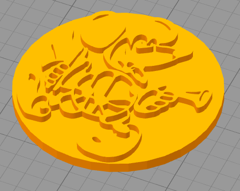

I found a graphic of the logo you mentioned and that would be challenging not because of the size but because it’s a collection of disconnected segments.
Tinkercad would allow you to print such a logo, but you’d have to learn how to create a vector file, import it, then raise it up and put a platform under it. Such a curious logo!
At this point in the discussion, I have no ideas to toss at you. If you develop an idea and need technical assistance, I’ll do my best to help, but the brain drain part (idea) is up to you.
If you wanted to use the Adolf Gallard logo, consider to view this video tutorial which explains how to convert a bitmap (raster) image to a vector image, which can be imported with TinkerCAD. You could then extrude the logo, add a plaque behind it to connect the independent segments. If you have the skill to edit the g-code, you can insert a pause between the base plaque, change colors from white to black and continue the print, getting a black mouse on a white support.
Just for the fun of it, I converted the logo to .SVG, imported it with TinkerCAD, added a 3mm base and extended the logo to 2mm above the base. Dropped it into my slicer and the result was quite good:
I expect you should have similar results should you take on this specific objective.
