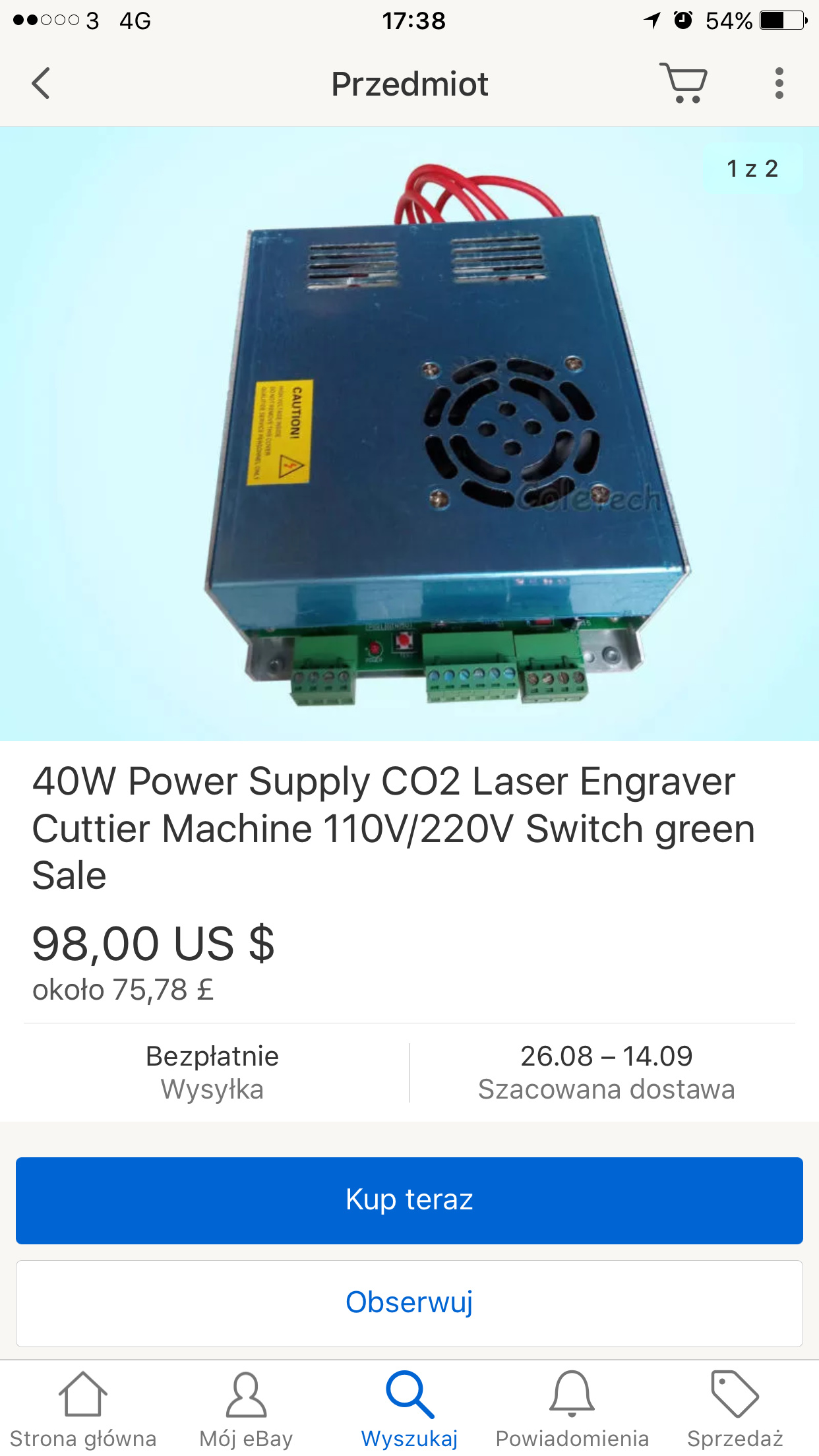

I need to get new psu to my K40 Im wondering what type is
Im wondering what type is better for smoothie board ,TTL or PWM controlled?
Now i had PWM with separate ignition pin(1
st picture) but wondering about getting new ttl conntroled
is there a differnce ? as far as I know the PWM pin is the power level and then you indeed have a shoot enable to let the laser shoot at the power level setup with the pwm signal
I read it ttl version works better because You use only one pin
you have to set power somehow ? Thats on the PWM input. If you PWM at a reasonable (fast enough frequency) or hookup a potentiometer, is doesn’t make a difference but at lease you need to set power somewhere ?
With smoothie board software set up power level,you dont need potentiometr
no because the power is set with pwm, so you still need a PWM/analog combined power level input and a TTL trigger input
Well to be sure i will get same type like was.but im sure when you use ttl version is the same pin for fire and power level.
I have a single pin setup smoothie it is not necessary to have a Pot to set max power but I use mine to ensure I don’t accidently overdrive my tube and allow for adjustments on the fly
