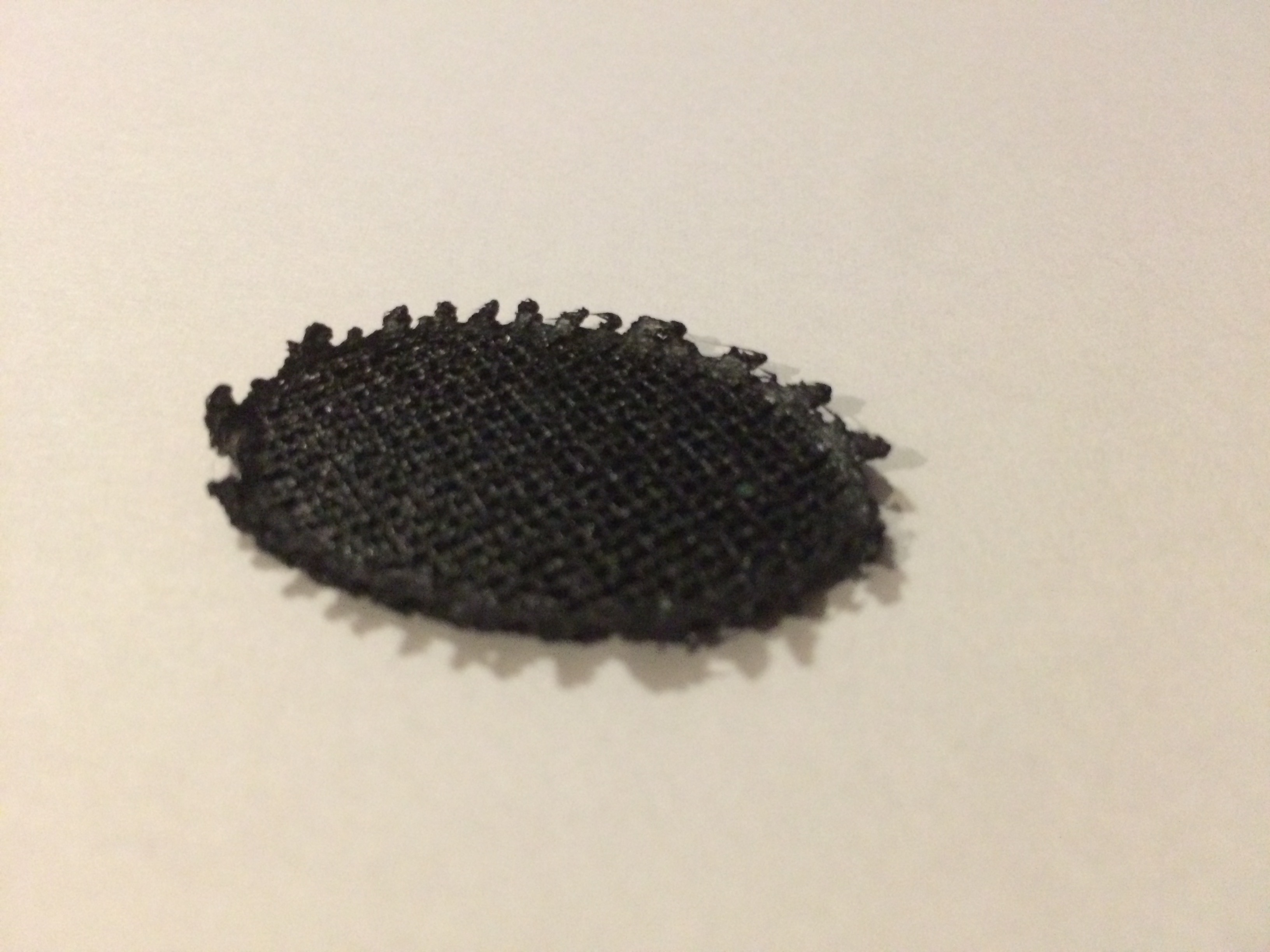

I’d like to print this: https://www.thingiverse.com/thing:2702654 but after about a few layers the print goes wrong, see the images. It seems like there were excess materials on the perimeter, which increas the height of the print and the head collapses on it of course. I assumed overextrusion, and reduced the extrusion multiplier down to 0.65 without no success unfortunately.
Small layer height 0.05-0.1 mm (I tried various layer height). REC ABS. 250C. E3DV6 direct extruder.
@Jeff_Ramble There is no support. That’s the problem at the edge what you see. :slight_smile: The outer edge should be flat, leveled with the rest of the object. But it gets higher.

@Jeff_Parish Yes, other prints are OK. As I’m using a direct extruder, and printing very thin layer, it means the extruder stepper is moving really slow. So the extrusion is really slow by default. It might be a slicer “error” as well. I’m using S3D. As you point out there is a rounded edge on the bottom. As I use 0.25 mm 1st layer height, the most outer perimeter of the 2nd layer seems to be hanging in the air. Now I’m testing with 0.15 1st layer height, and 0.6 mm manual layer width. According to S3D there is no perimeters hanging in the air.

So to finish this journey. I did all the preparations (bed leveling, new Buildtak sheet, filament drying). I was able to print OK with 200C extruder temp and 80C bed temp with 70% part fan with REC ABS. The perimeter speed was 10 mm/s to allow more cooling. With this low temperature the bed adhesion didn’t work, even with the new Buildtak. I used raft to fix it. Because of this the bottom side required a bit more work with sand paper.
I attach the picture of the finished part and in progress states.
