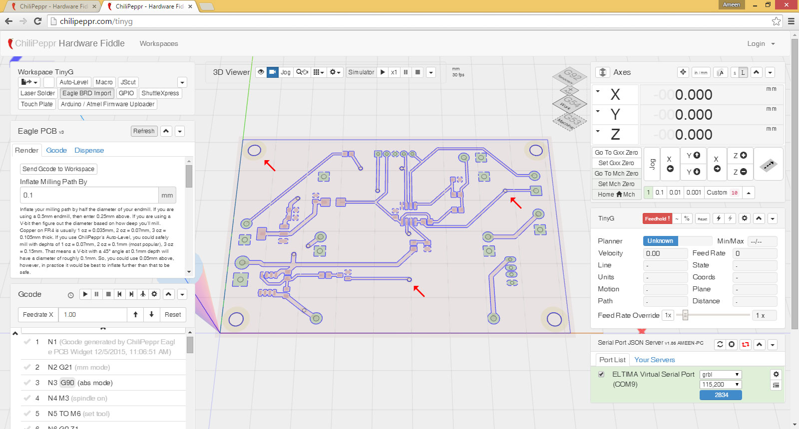

I noticed that Eagle Board Import widget of tinyg and grbl workspaces handle vias differently, check the two screen shots, apparently grbl ws traces via pads (which is what I expected) while tinyg ws traces via holes!

@jlauer Ok, i compared your and my version and can’t find any changes. Maybe here we have a problem with inches and mm? Please send me a brd file with an problematic via.
@Frank_Herrmann This post is 1 year old, I noticed today that via problem is still exists and now it’s in both TinyG and Grbl workspaces, I created sample eagle file to show you the problem, how can I send the file to you?
Here are some screen shots.
Could you post your Eagle BRD. Maybe I can make a quick change to the code.
