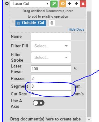

I noticed that if you define a laser cut,
I noticed that if you define a laser cut, the segment parameter can be zero however if you are trying to modify the materials library it is red and says it must be greater than zero. Is this a bug or just not addressed yet? I may as well ask what it is used for while pointing this out??? Thanks
Not sure whether that’s a bug or not, but the segment size changes the accuracy of curves. It was implemented a little while back when some of us noticed that some curves were coming out more like polygons instead of actual arcs. So lower value on the segment retains greater precision in the curve.
It’s a bug. 0 is valid.

this happens on several fields, just isn’t registering the default number. deleting it and retyping 0 clears it.
@Domm434 ​, you’re right. Thanks.
Fixed on last commit.
