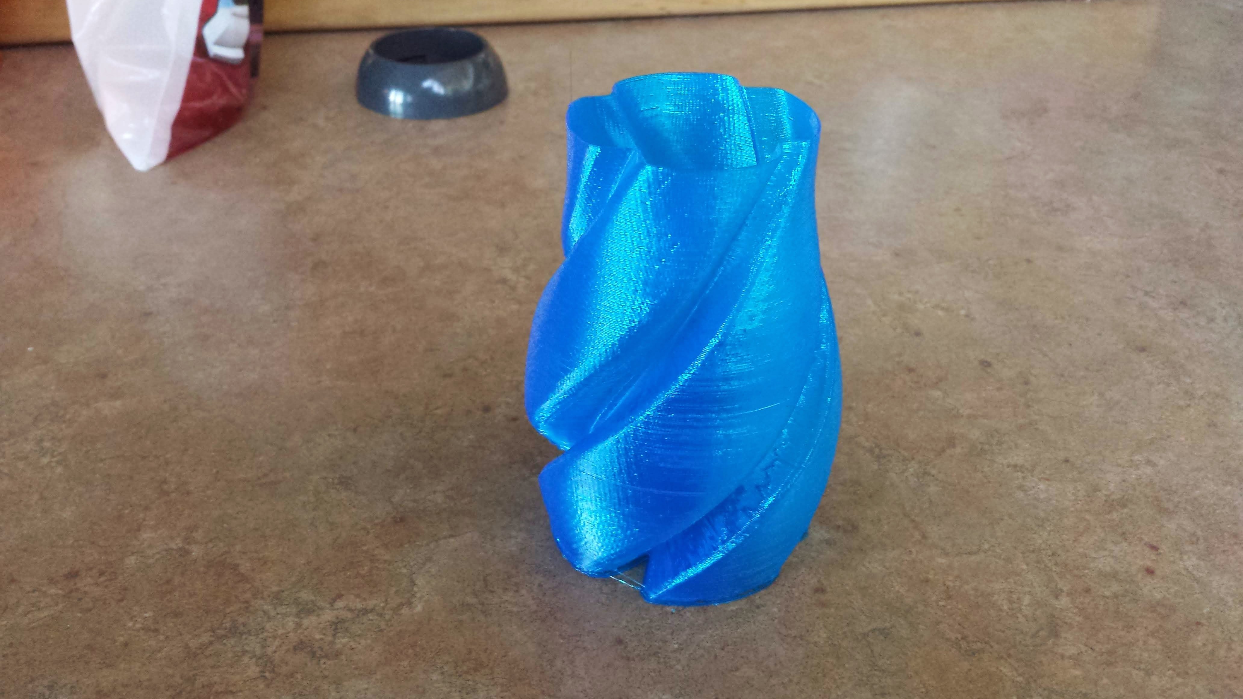

And yet I made the following rather successfully over the last few days…
