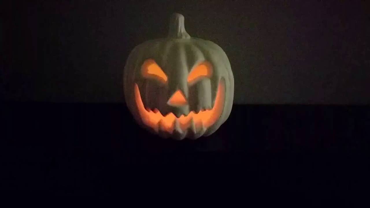

I picked up a cheap white styrofoam Jack O' Lantern on clearance at Michaels,
I picked up a cheap white styrofoam Jack O’ Lantern on clearance at Michaels, and lit it up using a Gemma, 24 NeoPixel ring, and a 3xAAA battery holder. Nothing too fancy, but thought I’d share. :slight_smile:
Build pics: https://photos.google.com/share/AF1QipPtwt5Y47IGnpyEwJVkRbp9ZZwVgTo3RtmZbfDBjwl1-OjBWT0VI6s-EFGFDXvZ4Q?key=bEhQTFBXVHZTYWh1ZmgtNmgzQ3ZDSlJiQjM5WGRR
Source code: GitHub - jasoncoon/fastled-jack-o-lantern

Thanks! I definitely wouldn’t recommend the Gemma, I’d go with at least a Trinket Pro for more program storage space. I’m already running out with only two simple animations.
It doesn’t make any sound (but probably could), that’s just background music I added to the video. :slight_smile:
